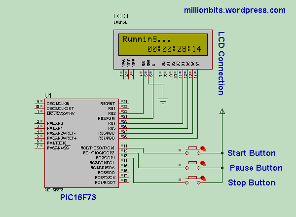

Open Proteus and draw the circuit as shown below.
Load the hex file and in pic and oscillator will be 20 MHz.Then Run.
