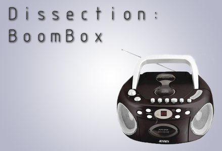

I recently picked up an older boombox and karaoke system that were both "broken" for free. I say "broken" because so far I haven't been able to find anything that's not working or not there other than the microphone for the karaoke machine. Which brings me to my first tip: if you get an appliance for free, give it a good once over before taking it to pieces. Some people are simply not very technologically inclined and mistake user error or a need for usual maintenance as "broken". So you may end up getting a perfectly good appliance or other device for free (that's how I got my latest monitor). Today I'll be taking apart the boombox, the karaoke machine will be dissected in the next installment. So without further ado, let's get started.

We'll start by removing all of the exterior screws. This model conveniently has all the screws located out in the open, but some may try to hide screws in the battery compartment or under stickers, so check there if you can't get it open after removing any visible screws. With the screws removed we should now be able to open the housing and expose the circuitry inside. Wires can be quickly disconnected by bending the wire back and forth at the solder joint on the board, or a pair of snips will get the job done even faster. Disassembling the boombox is now a simple matter of finding all the fasteners holding it together and disconnecting any electrical connections.

All together, I'd say this small boombox was worth taking apart. It took about an hour and a half to salvage all of the desirable components and was able to stock up on some essentials. A bigger system would probably be better worth the time, such as the karaoke system (I'll either add that on as an update or make another instructable). Thanks you for reading! If you found this useful, let me know in the comments and I'll try to make some more.
