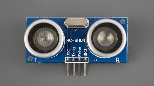

The image below illustrates the HC-SR04 ultrasonic sensor.

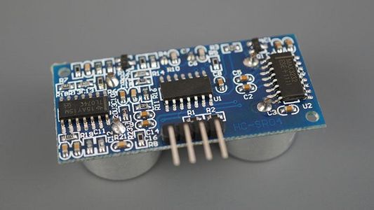

The subsequent image reveals the reverse side of the sensor.

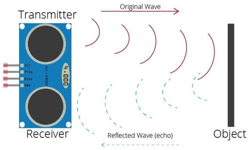

The ultrasonic sensor employs sonar technology to determine the distance to an object. Here’s a breakdown of its functioning:
  1. The ultrasound transmitter (trig pin) emits a high-frequency sound (40 kHz).
  2. The emitted sound travels through the air, and if it encounters an object, it reflects back to the module.
  3. The ultrasound receiver (echo pin) picks up the reflected sound (echo).
By considering the speed of sound in the air and the time it takes for the signal to travel (elapsed time since transmission and reception), we can calculate the distance to an object. The formula for this calculation is as follows:
distance to an object = ((speed of sound in the air)*time)/2
  • speed of sound in the air at 20ºC (68ºF) = 343m/s

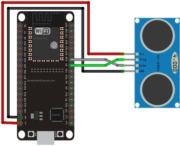

Step 3: Schematic – ESP32 With HC-SR04 Ultrasonic Sensor
Wire the HC-SR04 ultrasonic sensor to the ESP32 as shown in the following schematic diagram. We’re connecting the Trig pin to GPIO 5 and the Echo pin to GPIO 18, but you can use any other suitable pins.

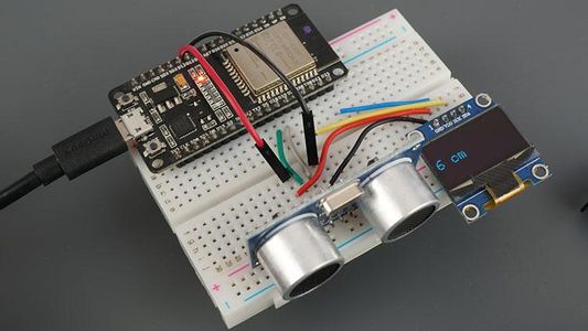

Step 5: ESP32 With HC-SR04 and OLED Display
In this section, we provide a straightforward example featuring the ESP32, demonstrating the presentation of distance on an I2C OLED display.
For a more comprehensive understanding of how the project functions, we recommend referring to our ESP32 tutorial involving the I2C OLED display.
Schematic Diagram – ESP32 with HC-SR04 and OLED Display
Connect all the components according to the schematic diagram given below.
