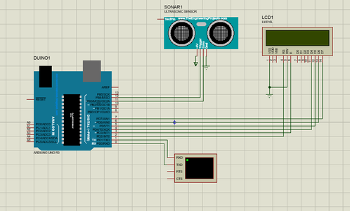

Introduction: CIRCUIT DIAGRAM & CONNECTIONS
GIVE THE CONNECTIONS AS PER THE CIRCUIT DIAGRAM.
1) Vcc pin of Ultrasonic Sensor is connected to 5V power terminal.
2) TRIG pin of Ultrasonic Sensor is connected to PIN 9 of Arduino ECHO pin of Ultrasonic Sensor is connected to PIN 8 of Arduino.
3) GND pin of Ultrasonic Sensor is connected to GND terminal.
4)Led with 220ohm resistor connected to PIN12 of arduino.

Hello all. I'm going to do a simple DIY - "DISTANCE MEASURING INSTRUMENT" using an ARDUINO UNO. Let's get started.

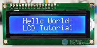

Step 4: OPERATE IT
NOW KEEP THE SCALE'S 0 AT THE BEGINNING OF THE ULTRASONIC SENSOR AND BRING ANY MATERIAL AND NOW YOU CAN SEE THE MEASUREMENT IN THE LCD MONITOR. YOU CAN CROSS-VERIFY THE DISTANCE WITH THE SCALE.
