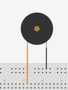

The first component that we will connect will be the sensor. Remember in the beginning that the signal terminal will be connected to the ardunio, well now it's time to connect it. In the beginning, we connected the signal terminal onto the breadboard so now we will add a jumper connection from that row to the arduino. The pin that I had used to connect the sensor is pin number 12. Again, it doesn't matter what digital pin you use as long as you know which one is connected to what. This will be useful when we are doing the coding of the circuit.
Now the sensor has been connected, it is time to connect the buzzer. The same process begins here as well. We will do a jumper connection from the pin that the buzzer was connected to on the breadboard. The pin that I had connected the buzzer to is A0. Remember that an analog pin can act just as a digital pin.
The image that I have attached above should look very similar to the circuit that you had built on tinkercad.

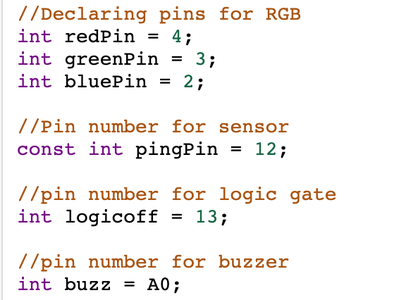

Step 12: Declaring RGB, Sensor, Buzzer, and Logic Gate
This step will be quite long so be ready! We will now declare the pins for the RGB LED, sensor, buzzer, and logic gate.
//Declaring pins for RGB
int redPin = 4;
int greenPin = 3;
int bluePin = 2;
//Pin number for sensor
const int pingPin = 12;
//pin number for logic gate
int logicoff = 13;
//pin number for buzzer
int buzz = A0;
The same process applies here as well. I wrote down a comment stating that I'll be declaring the pins for the RGB, sensor, logic gate, and buzzer. I stated that the RGB pins, the sensor pin, and the logic gate pins are int values so there will be a numeric value given to the components. Again you can see that I have stated to which pin each of the components has been connected to, and at the end when I'm done with that particular line I add a semicolon to move onto the next line. If you forget to add a semicolon there will be an error shown when you run to simulate the program.
Now for the logic gate, I called the variable as logic off. Since the output of the logic gate is being connected to pin number 13 I wrote int logicoff = 13;.

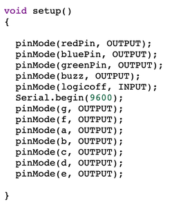

Step 13: Void Setup()
Throughout the code, this is the most important part. The void setup is the part of the code where you will declare your inputs and outputs. The first thing you will do is write a void setup like this "void setup()". When you are done writing this done you will press enter and add a bracket that looks like this "{". This is where you will write down the code of your inputs and output.
void setup()
//declaring inputs and
pinMode(redPin, OUTPUT);
pinMode(bluePin, OUTPUT);
pinMode(greenPin, OUTPUT);
pinMode(buzz, OUTPUT);
pinMode(logicoff, INPUT);
Serial.begin(9600);
pinMode(g, OUTPUT);
pinMode(f, OUTPUT);
pinMode(a, OUTPUT);
pinMode(b, OUTPUT);
pinMode(c, OUTPUT);
pinMode(d, OUTPUT);
pinMode(e, OUTPUT);
What is pinMode?
pinMode is a very important unique function. The purpose of this function is to allow the components that you have connected to the arduino to act as an input or an output. So when you write pinMode, you add parenthesis and state what component you are stating as an input or an output. For example, I said that the buzzer will be output. Since I stated that the buzzer is buzz I wrote pinMode(buzz, OUTPUT);. This process repeats again for the other components as well.
As you can see from the code above that I have stated that the pins on the seven segment display are output pins since they will be stating a number such as 3, 2, and 1. I also stated that the pin for the RGB are output as well since they will be displaying a particular color such as green, yellow, and red. The buzzer is also an output pin since it'll buzz when the inches of the sensor are less than 10 inches. Now the only difference you will see that that the logicoff will be an input value. The reason for this is because the logic gate has no purpose to output a value. When both of the slide switches are turned on the value of 1 will pass through the jumper wire that is being connected and turn off all of the components on the breadboard. So therefore I stated that the logicoff variable is an input, not an output.
Also, you may have noticed that the output and input are in capitals. In C, you must state these inputs and outputs in all caps.

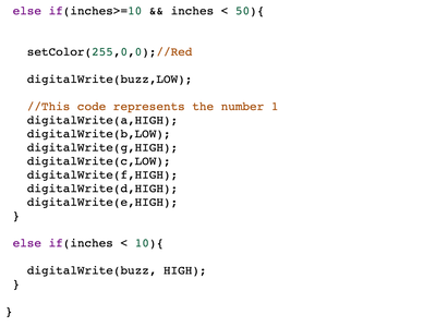

Step 15: If Statements
The last part of the while loop is to add if statements. The purpose of these if statements are to execute the RGB colors, and output the numbers from the display. For example, in some certain range the color green list up or yellow, and even red, and then the corresponding number will be output. For the first if-statement, I stated that if the inches are greater than or equal to 100 the color green is outputted. So I coded the hex number of green. I also stated that the buzzer is at low meaning that it won't buzz. The reason for this is because when the inches are less than 10 the buzzer will buzz, but when I go over 10 the buzzer won't stop buzzing. This is due to the code that we wrote. Since we didn't state that the buzzer should stop buzzing once over 10 inches it'll continue to buzz until you turn off the program. That is why in each situation we wrote down that the buzzer must be at the state of low until it goes under 10 inches.
This "&&" means and. So when typing down my code I had to write two conditions. This allowed me to have a range between two values.
Also, you can see that I wrote down the inputs of the seven-segment display as high or low. Now, since the display is a common anode in order to turn on a specific part of the display we must write "LOW" instead of "HIGH". If the display was a common cathode we would have coded the opposite. Since I want to display the number 3 I wrote down specific pins that have to be turned on and off in order for that specific number to appear.
Now we move on to the next part of the code. We will be using else if statements since we want the if statement to be connected to one another. The same process repeats. I wrote the range to which the inches should be and displayed the color yellow, and coded what pins on the display should be high or low to display the number 2.
The same process happens again, I coded the range to which the color red should be outputted and then coded what has to be high or low to output 1. The last if statement was when the sensor goes underneath 10 inches. Once under 10 inches the buzzer buzzes so I wrote the buzzer as HIGH.
