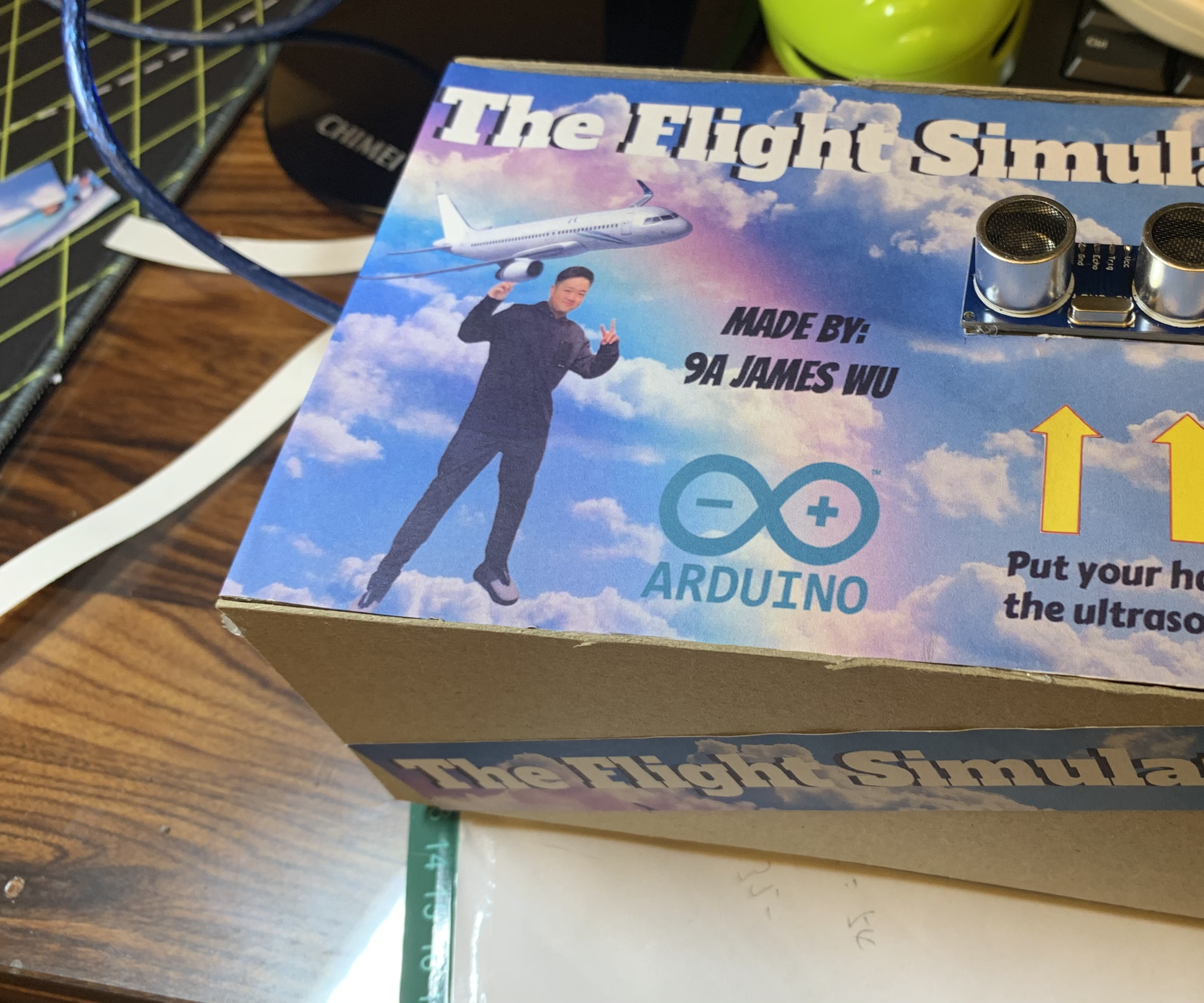

I made a cardboard stand for connecting the Ultrasonic sensor to the Servo motor. I folded it like it’s shown in the picture, glued it, and secured it to the servo motor using a screw-like this. Also, I attached a pin header on which I soldered 4 jumper wires for connecting the sensor. Finally, I taped the servo motor to the Arduino Board using an elastic band. I connected the Ultrasonic Sensor HC-SR04 to pins number 10 and 11 and the servo motor to pin number 12 on the Arduino Board.
