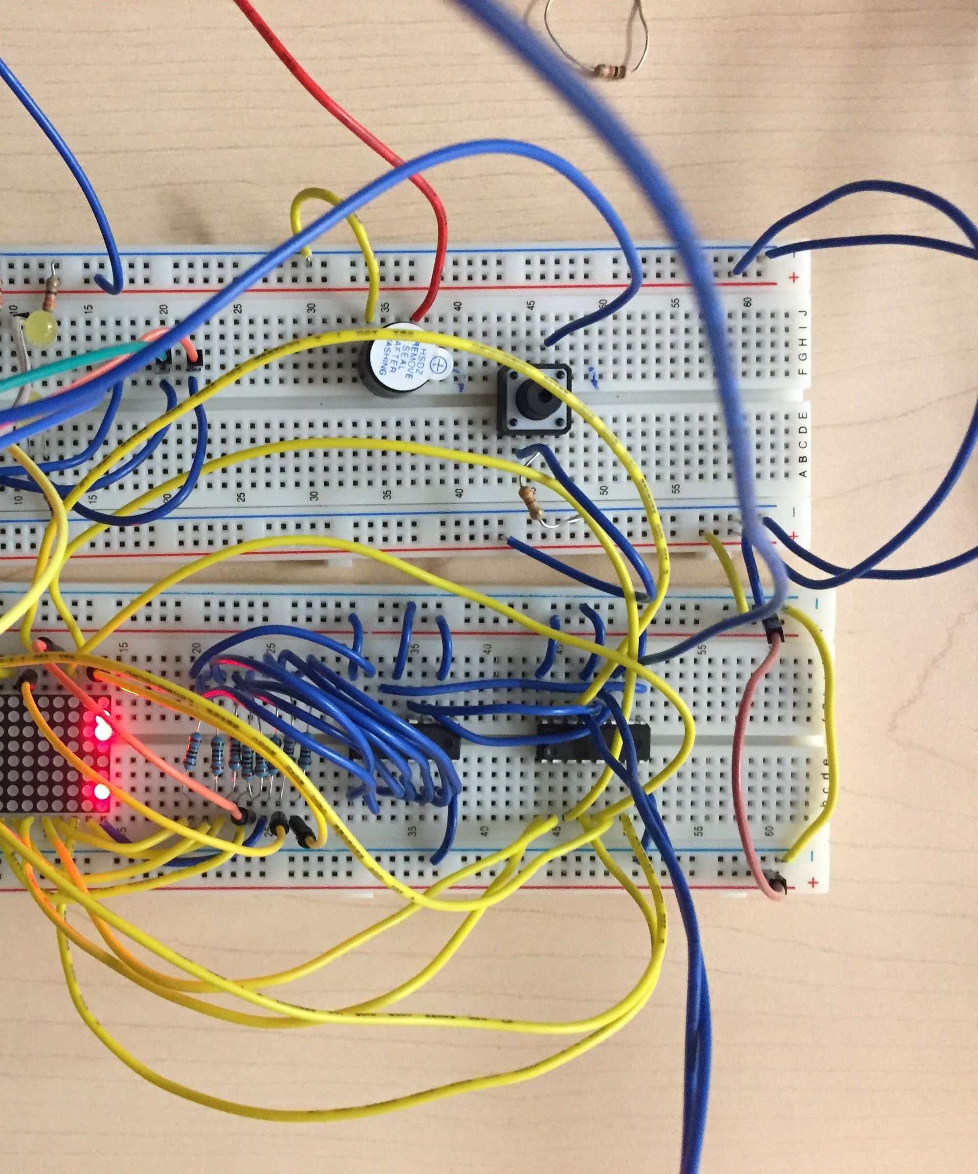

Step 1: Adding the H-Bridge
The first step is to wire in your H-Bridge that will control your motor. I used the instructable down below to help me build this part. The picture above shows you what the finished result looks like. The pins that connect the H-Bridge to the arduino are the ones that are used in the reference instructable. The coding behind this H-Bridge came from the second link down below.
PS: Due to faulty equipment, my H-Bridge was unable to control my motor so I was led to control the motor with the use of just simple wiring to the power and ground rail.
Reference To H-Bridge Build: https://www.instructables.com/id/Introduction-90/
Reference To H-Bridge Code: https://www.instructables.com/id/Writing-the-Code-...

Step 5: Update: Arduino Board
This picture is what the arduino board will look like once you utilize all your components.
