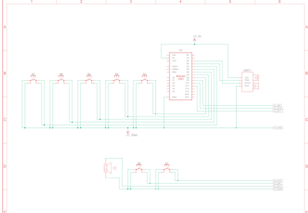

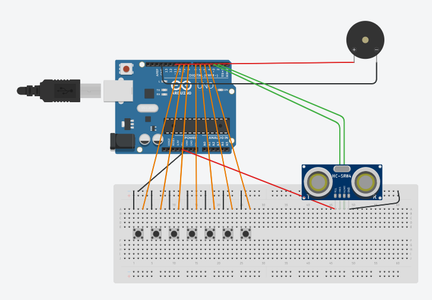

Step 1: Wiring Main Piano (push Buttons and Wires)
For wiring, the tinkercad and schematic of this project can help with connecting everything together.
For each push button, the left side should be connected to the ground, while the right side should be connected to the arduino pins
The buttons should be connected from D10 all the way to D4
Each of this pins control each button, which controls a specific pitch and tone so that each button has it's own unique sound
Buzzer's power should be connected to D11, while it's ground lien should be on the ground next to it.
Step 2: Wiring on Distance Sensor
Here you can see the wiring for the second part, which is the distance sensor next to the Piano itself.
The distance sensor should have its power line directly on the 5v of the arduino, with trig on D3, and echo on D2 with ground on the main ground line on the arduino.
Very simple itself.
Step 3: Image of Arduino Pin Connections
You can simply see here to double check any errors or misplacements.
