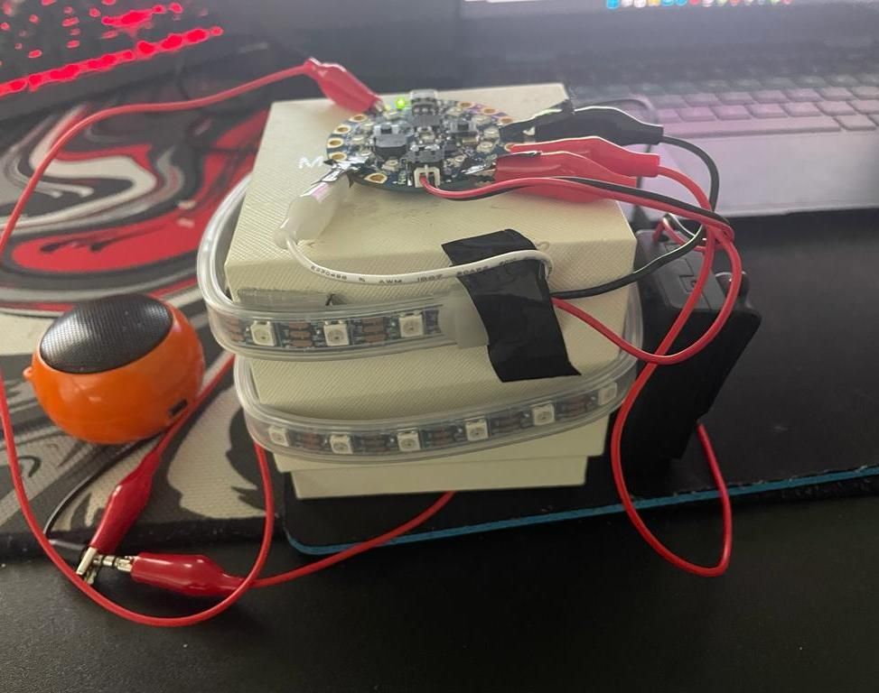

My final project is a new feature added to the robot that we made for our course. It is a distance sensor, which identifies if the robot is approaching an object. The objective of the project is to prevent the robot from colliding with any object and thus could break or damage
  • 9 alligators clips
  • 1 CPB
  • 1 portable chargeable battery
  • 1 Distance sensor (APDS 9960)
  • 1 LED strip
  • 1 speaker
  • 4 male-to-male cables
** these are the supplies for the distance sensor feature, you can also use it in other things like toy cars
Step 1: Code Your Sensor
Write your code and save it in your CPB.
Step 2: Put Everything Together
you have to connect the LED strip, the distance sensor, and the external speaker using the alligator clips and the male-to-male cables.
for the distance sensor:
YELLOW = SCL
BLUE = SDA
BLACK = GROUND
RED = POWER
for the LED strip:
RED = POWER
WHITE = SIGNAL
BLACK = GROUND
for the external speaker:
connect 1 alligator clip to the tip and 1 more to the bottom of the cable
BOTTOM = GROUND
TIP = AUDIO
