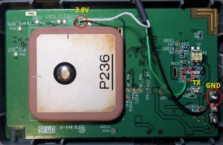

Step 2: Finding Proper Power Source for the Microcontroller and LCD
As shown in the picture, 30 gauge wires were soldered directly on the GPS pcb, on V28A (2.8V), TX, and GND.
The GPS, Holux M-1000 has TX and RX pins available on the USB mini-B port, but I needed only TX pin to send data to the microcontroller. Using a magnifying glass, I followed the trace of the USB pin and flipped the PCB over and found the spot to solder the wire for the TX pin.
The wire for the GND line is simply soldered to the battery contact pin.
The LCD and JeonLab mini board consume not much current, so with the built-in battery pack on the GPS, it lasts more than 10 hours with even the backlight of the LCD on.
