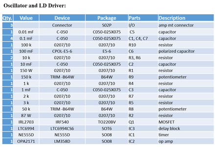

The oscillator used here is based on simple 555 timer IC in astable operation. The circuit diagram is shown in Fig.2. Using a 50 K potentiometer (R8), frequency is set at ~ 2.1 kHz. The duty cycle is ~ 50%. The output of the oscillator is fed to a MOSFET via a buffer (OPA2171), which is driving the LD. The LD used here, is a cheap laser pointer. The laser pointer has an LD as well as a focusing lens in front of it. While using an LD in pulsed operation, we have to consider its protection as well. Resistor R2 (87 W) is used to limit the current within the safe level of ~ 40 mA. A ferrite bead (FB) in series and a ceramic capacitor (0.1mF) in parallel to the LD is used to achieve slow rise and fall time of the current through the LD. As mentioned earlier, oscillator output will also be used as a reference input for the lock-in-amplification. The buffered oscillator output cannot be effectively used directly for this purpose. Because of the LD protection circuit there will be a little delay in turning ON and OFF the LD; also there will be delay in sending the pulses and receiving the signal also known as time of flight (TOF). At the receiving end, the phototransistor detector output is amplified and filtered, these circuits also introduced some delay. To match with the delayed pulses the reference signal also needs to be delayed. The pulse delay circuit is implemented by an IC, LTC6994. The amount of delay can be adjusted by a 150K pot (R9). Before being fed to the reference input, the DC component of the pulses is removed by a capacitor C3. The implemented PCB is also shown in Fig.3. The oscillator output or the LD driver input and the delayed output waveforms are shown in Fig.4 and Fig.5, respectively.

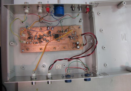

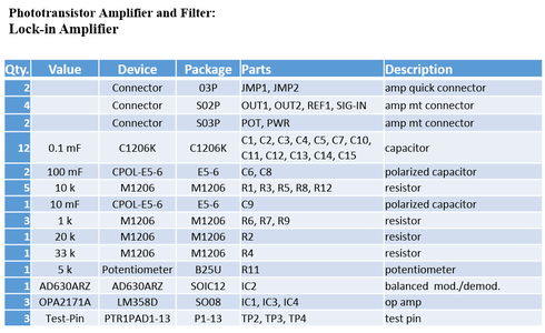

The pulsed laser light is incident on the object to be detected and only a tiny fraction of the scattered light reaches back to the detection system. This scattered light is detected by a phototransistor. The phototransistor is fitted to a 5 mm diameter and 15 cm long metal tube to make directional sensing possible. The phototransistor current is amplified by an op amp (OPA21180). Along with the pulsed scattered light from the object, ambient light or background light also generates photo-current. 60 Hz line hum is also present at the amplifier output to a little extent. To remove those unwanted signal and background noise a simple notch filter is used. The passive components are chosen to pass only the pulsed light signal at 2.1 kHz. Other signals and noises are heavily attenuated. The phototransistor and the amplifier-filter is implemented in the same PCB, and put in a small enclosure. The cable from this enclosure carries photo-signal to the lock-in amplifier and power also comes to it from the common power supply. The schematic and the implemented PCB is shown in Fig. 6 and Fig.7, respectively.

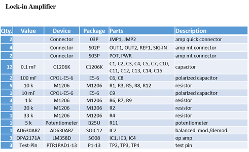

The heart of the detecting system is a balanced modulator, implemented by IC-AD630 and is shown in Fig.8. AD630 has two inputs, we can name one a signal input and other a reference input. The signal obtained from the photo-detector is amplified by IC1A (OPA2171A) and applied to input RINA. The delayed reference signal is applied to the other input SEL. We can either apply to SEL_A or to SEL_B, depending on the polarity of the reference signal. Either of these two inputs is selected by two jumpers. The polarity of the detected output voltage depends on these jumper selectors. As the expected output is of positive output voltage, we can change the jumper position, if we find negative output.
The
balanced modulator (AD630) actually multiplies the two input signals and the multiplied result is produced at the output. Only the two signals of exact frequency and phase will produce a DC output, others will cancel out. That is why lock-in detection is a good technique to detect only our desired signal, though very weak in nature. As the output is a pulsating DC, a passive RC filter consisting of R7 and C9 is used to obtain stable DC, it also filters out any small and fast variation of the desired DC output. As the scattered light produces very little signal, the resulting demodulated DC output is also very low, a DC amplifier consisting of IC3A and IC3B lifts this to usable level of several hundred millivolts to few volts. Off course the DC output depends on the distance of the object as well. The further the object the less is the output DC level. This output DC can be seen on a DC voltmeter or on an oscilloscope. The oscilloscope-waveforms of the signal input, reference input, demodulated output and amplified DC output is shown in Fig. 10.
