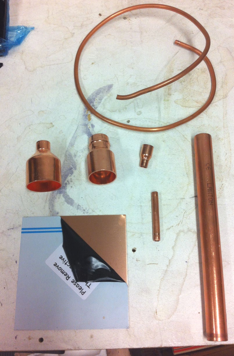

heres a list of what you will need
materials
22mm Copper pipe
6mm copper pipe
a small piece of 8mm copper pipe
125mm x 125mm copper plate 0.5mm thick
22mm copper end cap
35mm to 22mm copper reducer
45mm to 15mm reducer
15mm to 8mm reducer

Step 2: Making the Intake

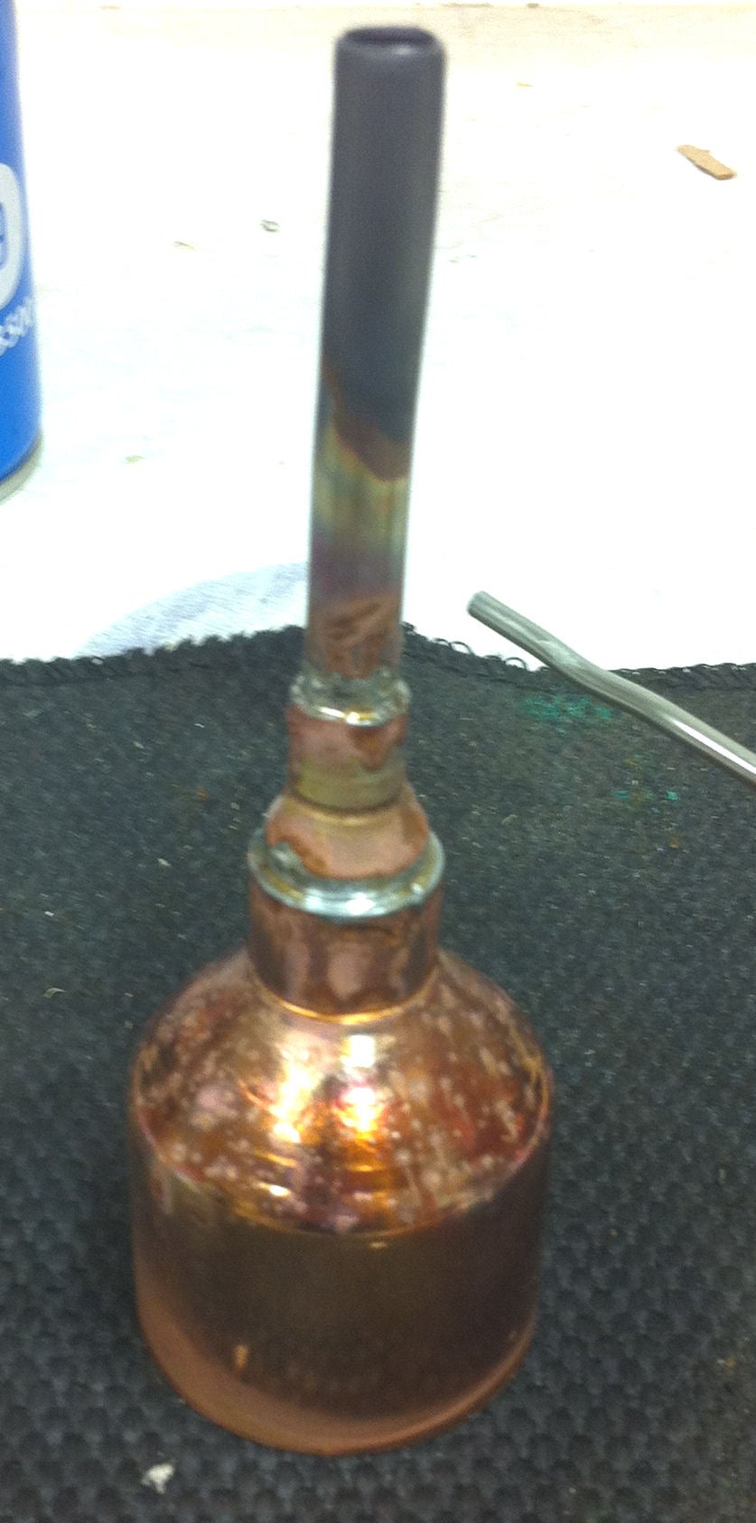

the intake will basically be a funnel leading down to a 6mm pipe which will go in to the bottom of the main tube, for this I had to use a couple of reducers chained together as I couldn't get a direct reducer to 6mm.
Making sure you flux each part before you heat it up, this will prevent oxidization of the surfaces and allow the solder to stick to the metal better.
Also you have to make sure the top of the intake will sit well above the top of the main tube, otherwise it will just over flow the intake and you will have spirit all over the floor, so bare that in mind when you are cutting your tubes.
Solder the 15mm to 8mm reducer in to the 45mm to 15mm reducer.
then Solder the 8mm piece of pipe in to the reducer.
then you will be able to cut a piece of 6mm pipe and shape it roughly to what you need and push that into the 8mm pipe and solder that in place too.
making sure you do all this on the heat proof mat, well I say heat proof its more heat resistant so when you do this make sure you are on a work bench as you are likely to scorch the surface you are working on.
if you have never soldered before then you should be aware that you don't want to heat the joint you are working on directly, you want to heat near it but not on it, the heat will travel through the piece, when the flux starts to bubble give it a couple more seconds and then try and touch the solder on it, if it melts then use it sparingly you don't want big blobs of solder all over the piece.

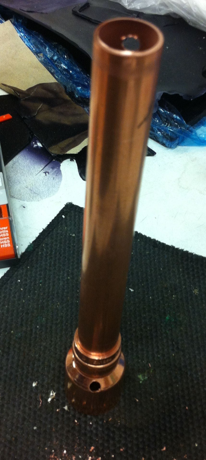

the main body will be a piece of 22mm copper pipe cut to about 26cm long, long enough that my hydrometer will sit in it all the way to the bottom but leave enough to me to grab the top of it should I need to remove it.
i'm going to use the 35mm to 22mm reducer to form a cup around the top so when the 22mm pipe over flows it flows in to the cup around it. but these couplers have a little bump inside to stop the pipe slipping all the way through, which normally in a central heating system you dont want to do that, but in this case I do.
Using a file or a dremmel you need to remove this bump so the 22mm pipe can slide right through.
now i need a 6mm hole at the base of the cup to attach out out flow pipe, I do this on the angled part of the reducer. using a center punch I put a small dent in there to stop the drill bit slipping, I could have put the piece in a vice but I chose to hold it with my hand wearing a welding glove. remove any bits of metal left around the hole using a file.
push the reducer on to the 22mm pipe, not forgetting to flux the pipe, and then using a table top or flat surface you want to make sure the top of the reducer and the pipe are at the same level, then solder the reducer in place.
at this point I made a small mistake and drilled a hole in the bottom of the pipe for inlet, later on this would prove to be the wrong thing to do.

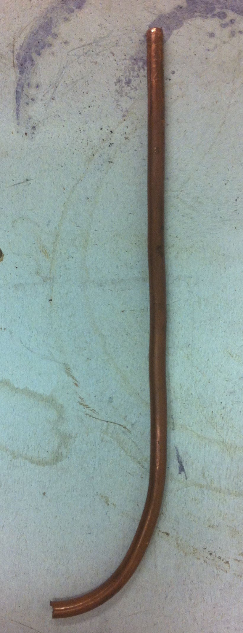

I could have just put a short straight piece of 6mm pipe in but I wanted something that supported the intake pipe, and lets face it the coiled look well it looks awesome.
to make the coil i wrapped the 6mm pipe around a wine bottle, it took a little force but I managed it.

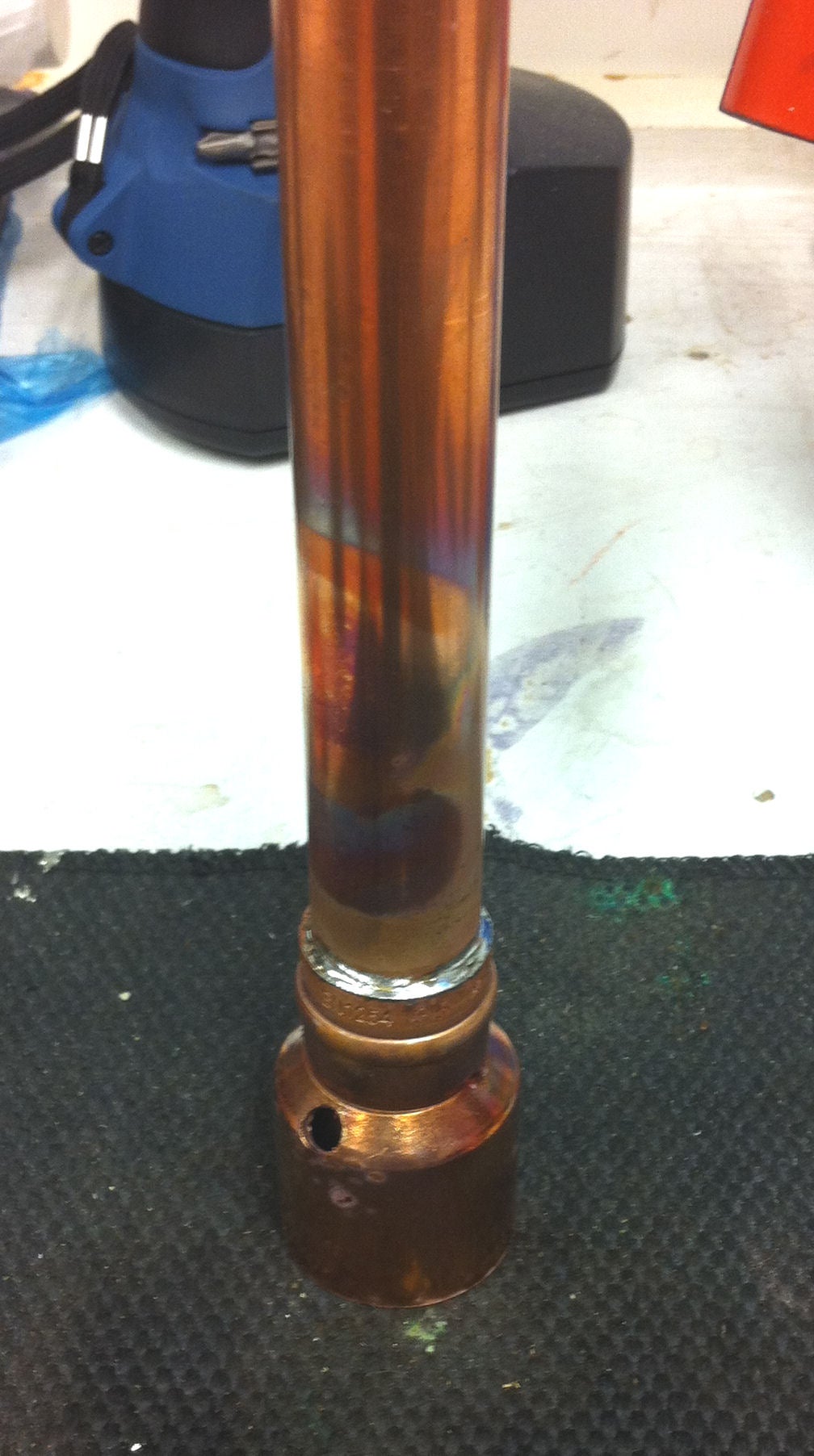

for the base i was originally going to use the copper place and solder the pipe directly to it, but unfortunately I didn't have any clamps big enough to hold the two while I soldered them. so I improvised and used a 22mm Copper end cap.
I had to do some measuring to make sure the new hole i drilled in the cap lined up with the one I already drilled in the pipe, if you are doing to use a cap like me it would pay to drill the hole in the cap first then put it on the pipe and drill the pipe so they match.
to drill the cap I put it in the vice and using a center punch put a small dent in to stop the drill bit slipping and drilled a 6mm hole.
then I got an off cut of 22mm pipe and put it in the cap, this would allow me space to use the blow torch later.
on the plate using a pencil I marked the middle and measured out to where the cap should sit so I would know I had it in the center.
I clamped the cap and pipe to the plate, making sure the plate was on the heat mat and that I had fluxed the cap first, then soldered the 2 in place.
I had to wait for the whole lot to cool before I could remove the pipe as the copper expands and locks the cap and the pipe together until it has cooled.
