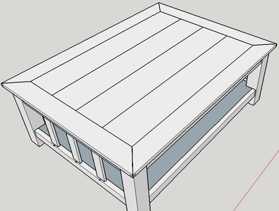

I am making 36" x 48" x 16" coffee table. The bottom half is pine, top half is reclaimed walnut flooring - approximately 100 years old. A resaw effect was done but most of the aging was natural to the pieces. Wood needed: (1) 4/8 sheet of quality 1/2" plywood. (4) 2x4x8 pine. (1) 4x4x8 pine. For the top, the walnut was 6" wide X 3/4" thick tongue and groove flooring. The pieces needed for the top are (6) 37" long, (2) 48" long.

Step 7: Table Top Assembly
- I made my rough cuts with the miter saw – (6) boards at 37” and (2) at 48”. With the miter saw I set up stop blocks for each series of cuts so that I could be sure each cut was the same. I oversized six of the boards because I needed to cut a tongue in on the ends. I wanted to have a little extra board just in case I made a mistake. In the end, the total board length for 4 of these should be 36 ½”. The tongue is ¼” on each end. The other two 37” boards will have 45-degree miters in them and should be exactly 36” on the long side of the board – tip-to-tip. Again, using a stop block will ensure accuracy on these cuts. The final two boards are the long ones and they should be 48” tip-to-tip with 45-degree miters on each end.
