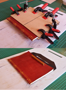

Step 8: Attaching the Leather Cover (Part 1)
The next step is to glue the signature to the leather cover. A straightforward way to work out the placement is to mark the left and right edges with masking tape, using the signature as a guide.
Please ensure that you take into account the space needed for the cover to wrap around and to offset the the placement of the signature by about ⅛" (3mm) on the right hand side.
I find it beneficial to start the gluing at the the edge nearest the spine of the signature, as this will allow for the most accurate placement.
Step 9: Attaching the Leather Cover (Part 2)
Once this initial strip of gluing has been completed, turn the book over and continue the process until you get to within ⅛" (3mm) of the edge of the paper. Leaving the remainder unglued will make it easier to trim the edge later on.
The next step is to turn the book over again and glue the cover the other side of the book.
This time only glue a 3rd of the cover. This ensures that the leather cover is attached to the signature, whilst allowing space to more easily attach the loop later on.
Step 10: Clamping the Book
Now clamp the book and allow it to dry for about 12 hours. Alternatively you can put the book in a press to dry.
Finally trim the top and the bottom edges of the book. This ensures that you squared up the shape of the book, prior to the external stitching being added. This can be achieved with a very sharp blade and metal ruler, but is best achieved by using a guillotine when the book gets beyond a certain depth.

The next steps are to shape the wrap around cover and prepare the pencil loop. The cover is shaped in a very rudimentary fashion. Feel free to adapt or abandon this aspect completely, however if you are going to make a much longer wrap around you will need to take this into account when cutting the leather out. I have included the measurements on the image above.
The loop is a 1½" x 4" (37mm x 112mm) piece of leather that has been stained according to the secondary colour of that house, in this case using 'Yellow Ochre'. Then once dry, it will need to be varnished and then distressed.
Step 18: Attaching the Loop to the Book
Next using the first slot as a basic guide, trace the shape of it onto the paper below. Then add an additional ¼" (12mm) onto each side to take into account the surface needed to securely glue the loop in place.
Glue one side down, then leave for about 30 mins to an hour to dry slightly, then loop the leather around the pencil intended for this design and adjust the placement of the other side if needed.
Next glue the other side of the loop in place. Leave to dry for another 30 mins to an hour.
Step 19: Clamping & Gluing Cover
Test the placement and sizes of the slots and adjust if needed. Remember the outer slot may need to be extended to facilitate the insertion and removal of the pencil loop.
Finally glue the front cover down, then clamp the book together and leave to dry for 12 to 24 hours.
The book is now complete.
