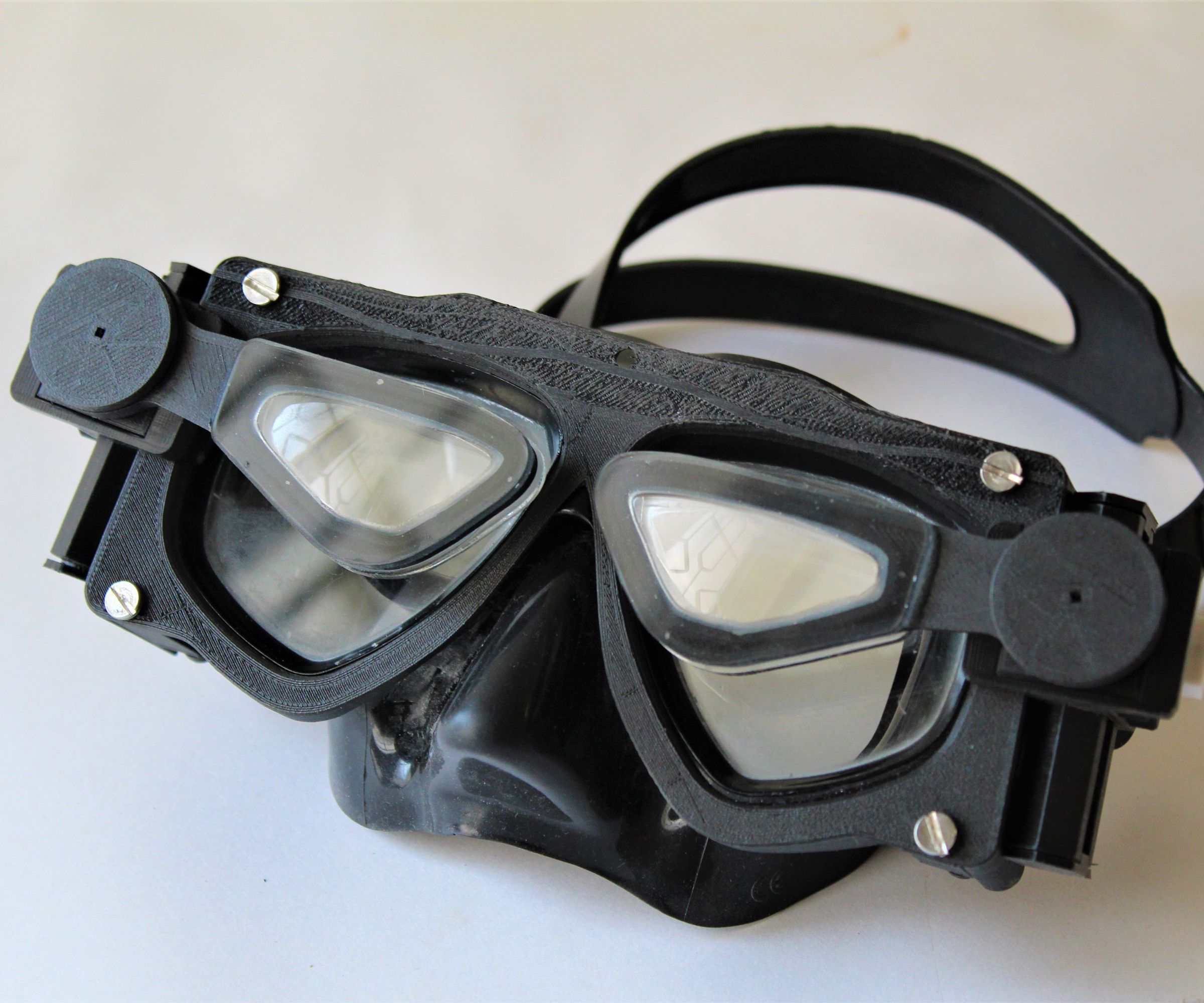

Step 5: Designing the Lens Holder
In order to hold and contain the corrective lens in an airtight container I used the following construction for the lens support frames which is illustrated above:
- The corrective lens is inserted inside of the lens support rim, which is designed to match the shape of the lens.
- The lens support rim has the same thickness or depth of the lens so that the lens fits inside the rim.
- The front and rear covers are glued (I used epoxy) to the rim with the lens inside the rim. This forms an airtight container for the corrective lens.
Step 6: The Add-on Outer Frame for the Mask
The design of the lens support frames has to be done at the same time as the design of the outer frame of the mask because the designs of both these frames are inter-related and inter-dependent.
The designs of the lens support frames and the outer mask frame need to be adjusted so that they match with each other. The lens support frames are screwed onto the slots on both sides of the outer mask frame. I used 4 mm dia brass bolts with butterfly nuts. The lens support frames can therefore be made to slide up or down the mask or slightly to the left or right depending on where the lens is required to be positioned during the dive. This is shown in the illustration above

When the screw and the butterfly nut (which hold the lens support frame) are loosened, the lens support frame can be either swiveled around (to turn the lens away when it is not required) or made to slide up and down the slot in order to adjust the position of the lens. However, loosening the butterfly nut causes both the swiveling and sliding of the lens to happen simultaneously, which is not always what’s required. For example if one requires to just swivel the lens and turn it away when it’s not needed, it is a bit difficult to do so without causing it to also slide in the slot. Moreover, this adjustment needs to be done using both hands at the same time; one hand holds the frame and the other handles the butterfly nut. The following feature improves the handling of the lens adding greater versatility and convenience for moving the lens support frame
Step 14: Gear Mechanism
A mechanism that would allow the lens support frame to be swiveled and rotated, one notch at a time, and with the use of one hand only, could not be found. It therefore had to be created. The following gear mechanism with a locking mechanism was designed and 3D printed. The idea was also to use materials that are resistant to salt water and also readily available to any diver who has access to a 3D printer.
The main body of this gear mechanism which is 3D printed holds a standard, common O-ring that is used for most SCUBA diving tank valves. I found that the 17.5 mm (11/16”) dia (OD) O-ring was of a convenient size. This gear mechanism can be customized according to the type of O-ring that you commonly use so that you can replace it easily. The O-ring acts like a spring and presses the two movable “teeth” against the rotating gear, locking the gear in place. When the gear is rotated, the teeth are pressed against the O-ring which gets compressed, allowing the gear to turn by a notch at a time. In this manner, the gear and the lens support frame which is attached to it can be rotated a notch at a time with one hand only. This has made rotating the lens much more convenient.
