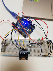

Step 2: MAKE THE CONNECTIONS on BREADBOARD
• Connect LEDs:
Green LED → Pin 9
Red LED → Pin 8
• Connect Buzzer → Pin 7
• Connect Button → Pin 3
• Connect Potentiometer: first pin → GND, middle pin → A0, third pin → 5V
• Connect OLED screen
VCC → 3.3V , GND → GND , SCL → A5 , SDA →A4

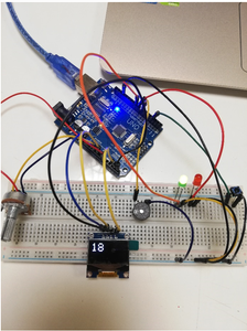

Step 6: DISCOVER THE RULE
• Create 8 different numbers that student will see on the OLED screen:
int mixed[8] = {122, 21, 39, 100, 22, 25, 45, 18};
• Display the numbers one by one in random order, keeping each number on the screen for 3 seconds. The teacher may ask students to take notes: numbers with the green light are evenly divisible by 3, and numbers with the red light are not, helping them understand the rule.
• If the number is evenly divisible by 3: green LED lights up, buzzer plays the melody.
• If the number is not divisible: red LED lights up, buzzer plays short buzzer tone.
Step 7: STUDENT TEST WITH POTENTIOMETER
• After discovering the rule, students will try their numbers by using the potentiometer. They can change the number that is seen on the OLED screen. Then, by pressing the button, they will check if the number is evenly divisible by 3 or not.
• Read the potentiometer from A0 and map it to 1–99:
int potValue = analogRead(potPin);
int number = map(potValue, 0, 1023, 1, 99);
• Display the number on the OLED.
• When the button is pressed:
If evenly divisible by 3: display “Divisible”, green LED, play melody.
If not divisible: display “No, sum is not a multiple of 3”, red LED, play short buzzer tone.
• Show the message after the number in size 2 font.
