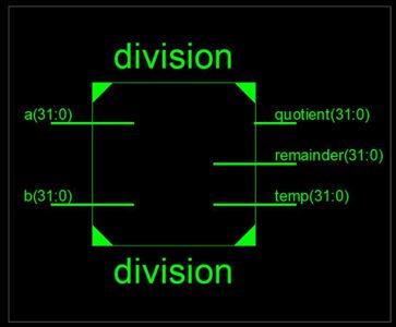

A Divider circuit using Virtex-7 FPGA is implemented. From the below shown output image
  1. a , b --> Inputs from user (a --> Dividend , b --> Divisor )
  2. remainder --> Remainder on dividing a by b
  3. quotient --> Quotient on dividing a by b
  4. temp , Flag--> A Temporary variable used for finding the required results
  5. bbar --> To find the 2's complement value of input b
  6. WIDTH --> Maximum value of 32 bit (1111 1111 1111 1111 1111 1111 1111 1111 --> 4294967295 )
On entering values for a and b , the process of "Repeated Subtraction" starts , where the value a is repeatedly subtracted with b and simultaneously checked with the same .The maximum value of quotient is the maximum value of 32 bit (stored in WIDTH) . If divided by zero , it displays 'X' ,because division by zero is not possible.
