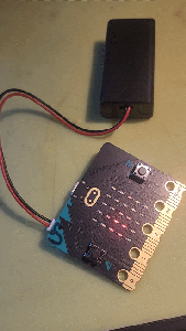

I wanted to create a flickering electronic Diwali candle light, very large, for a school cafeteria.

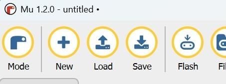

I was given a micro:bit by the school librarian to see if I could do something with it. You have to download Mu to run it. Mu is a very beginner IDE for python and extremely easy to use.
I used the simple code provided by Google AI.
  1. A computer set up with Mu, a kid friendly python IDE I've only seenon Raspberry Pi OS, but whih runs on Windows also. You can download at codewith.mu. Mu is no longer maintained so you will probably have to use win 10 OS.
  2. a micro:bit with battery case and AAA batteries and approproate cable to attached the battery to the micro:bit

  1. Connect the micro:bit to the computer, with appropriate USB cable, having downloaded Mu on the computer.
  2. Open Mu.
  3. Drag the following code to the editor of Mu.

Step 2: Flash the File
Flash the file to the micro:bit and turn on the micro:bit.
