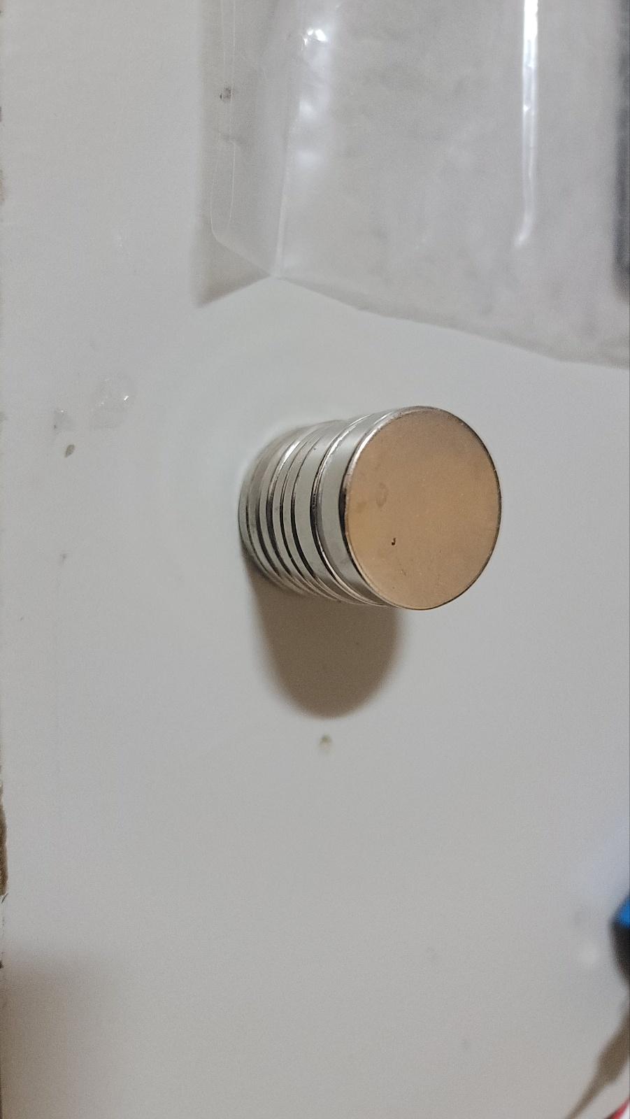

6.[Neodymium Magnet 5T]x12

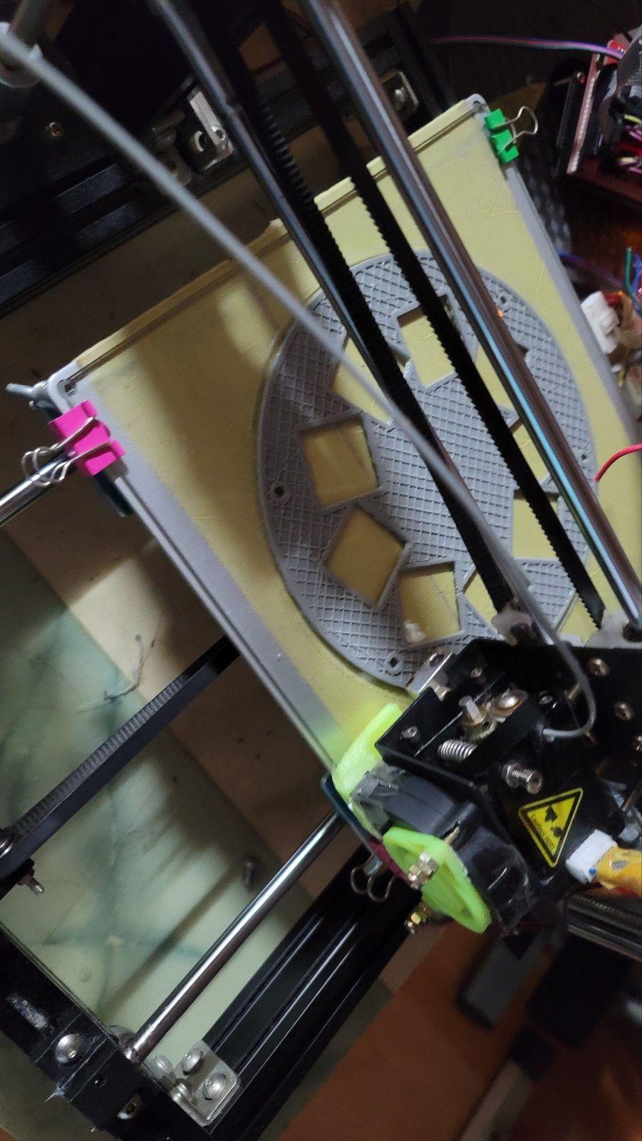

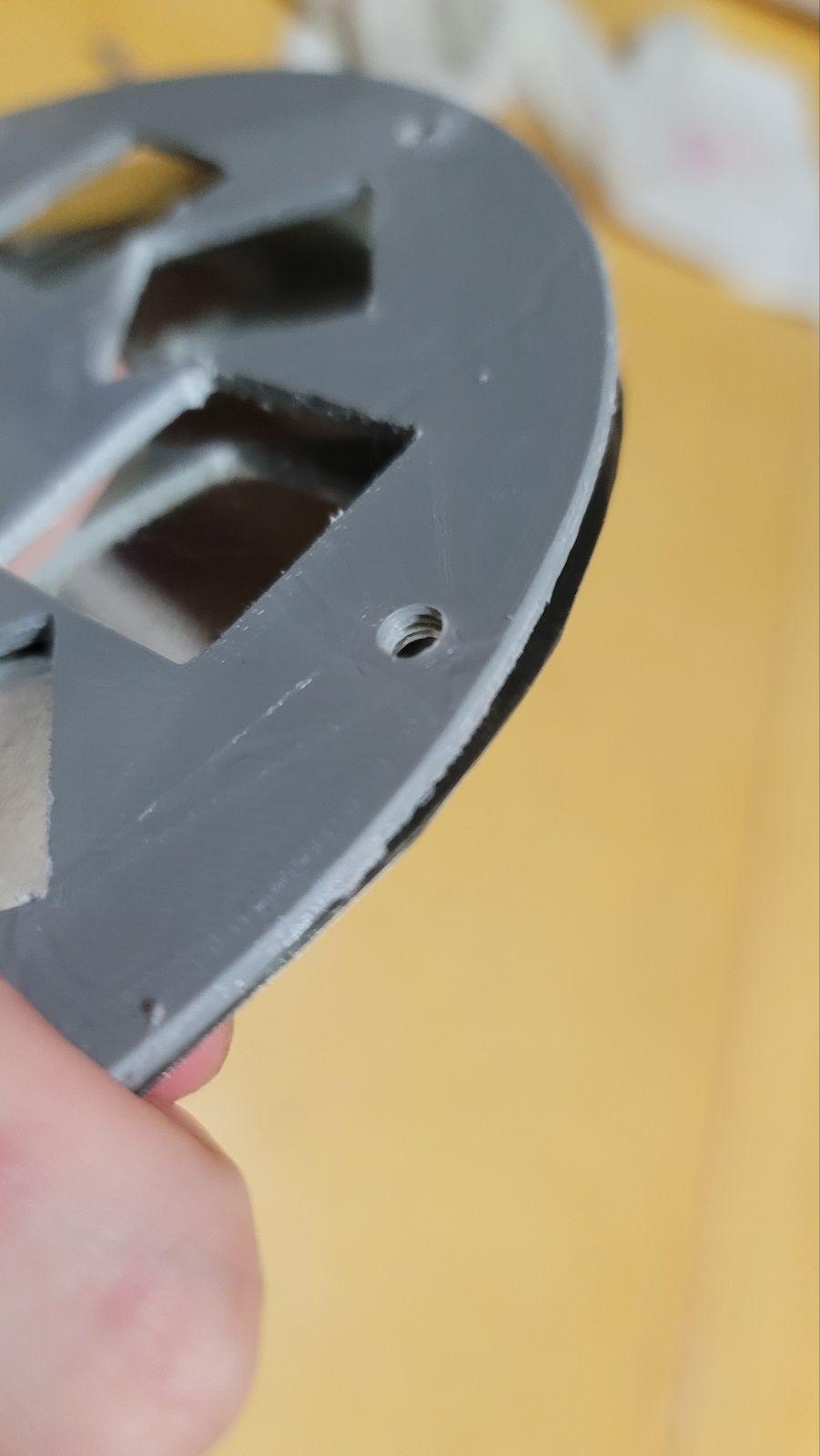

Step 1: PART PRINTING1
Print motor rotation parts.
Step 2: PART PRINTING2
Print motor case parts.

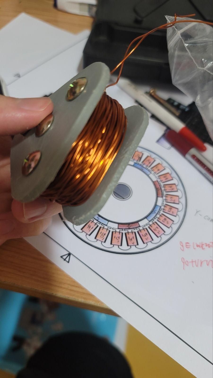

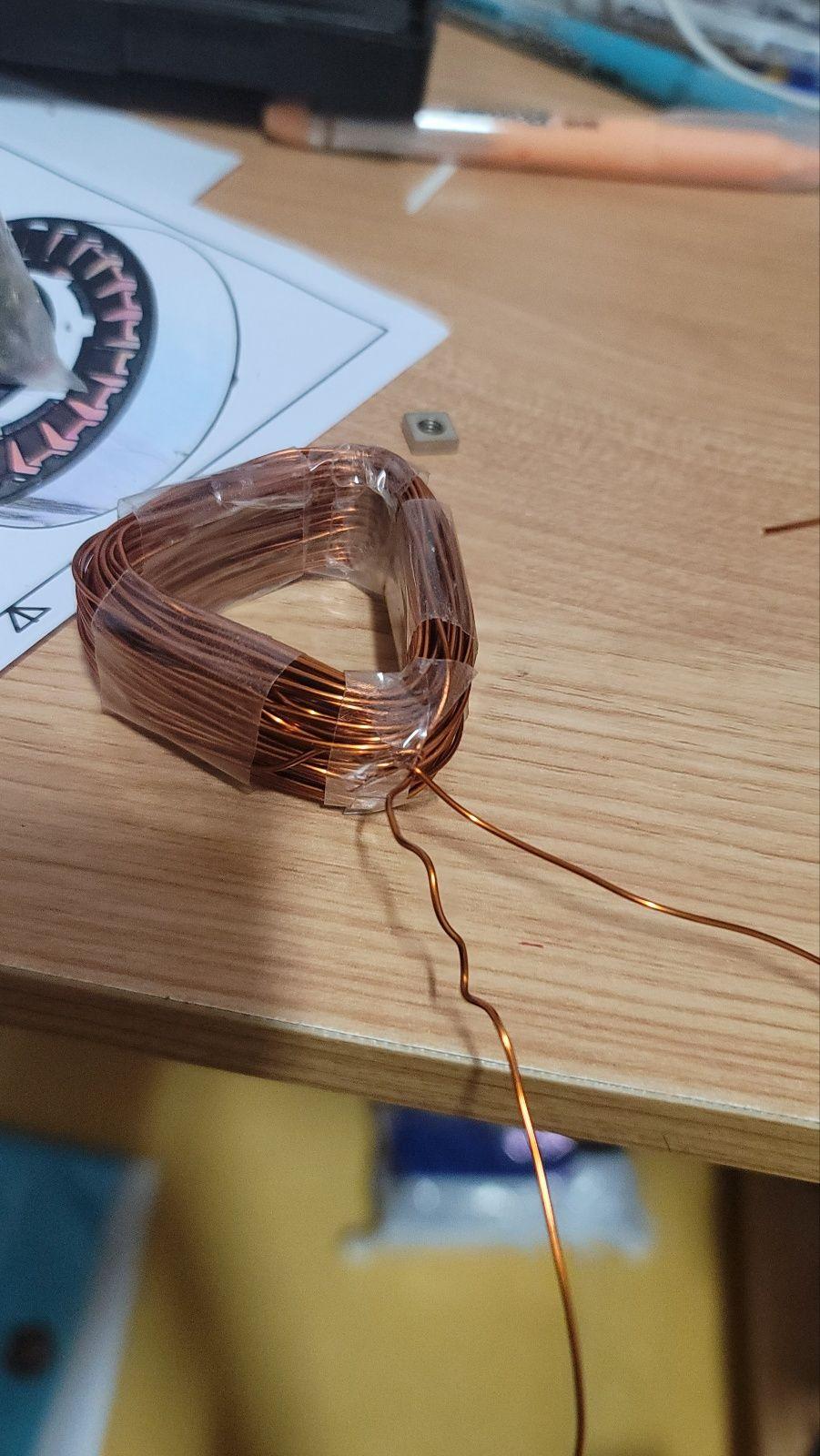

Step 3: COIL WINDING1
This is a fixture for winding the coil. Here, the coil was used with a thickness of 1mm. The bolt used is M5 brass material.
Step 4: COIL WINDING2
Wind the coil 110 times by hand.

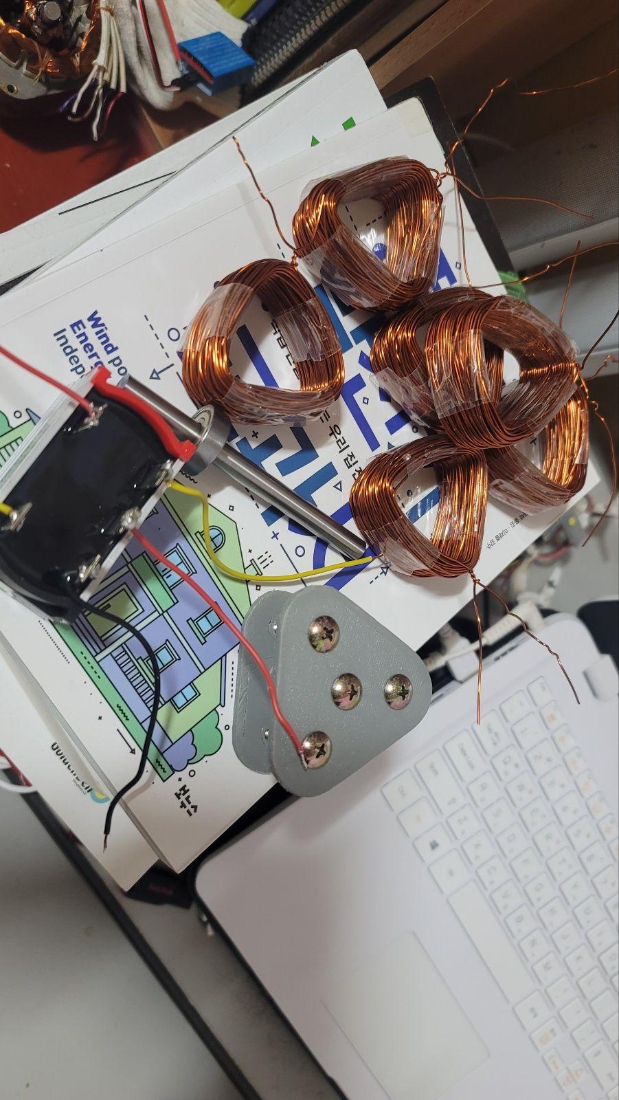

Step 5: COIL WINDING2
In this way, the triangle-shaped coil is completed.
Step 6: COIL WINDING3
Makes 6 of these.
*(The square metal visible in the photo is a converter.
Converts the 3-phase induced electromotive force generated when using the motor as a generator into direct current power. )

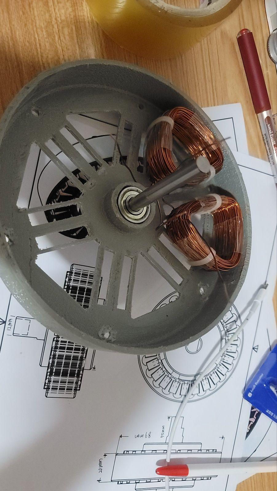

Step 7: Attaching Bearings and Axles to Case Parts
Install the shaft and bearings on the printed case part. Here, the shaft is 100mm long and 8mm in diameter, and the bearing is 806zz
Step 8: Mounting the Coil to the Case Part1

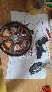

Attach the 6 triangle coils you made to the case parts. Secure with cable ties.
Step 9: Mounting the Coil to the Case Part2
Secure the remaining coils with cable ties.

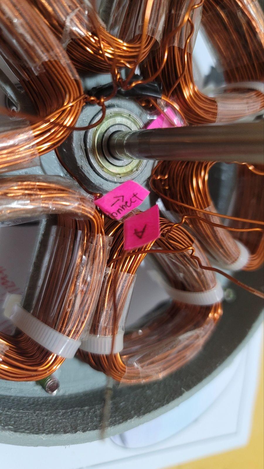

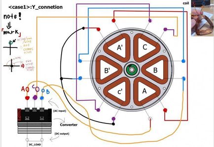

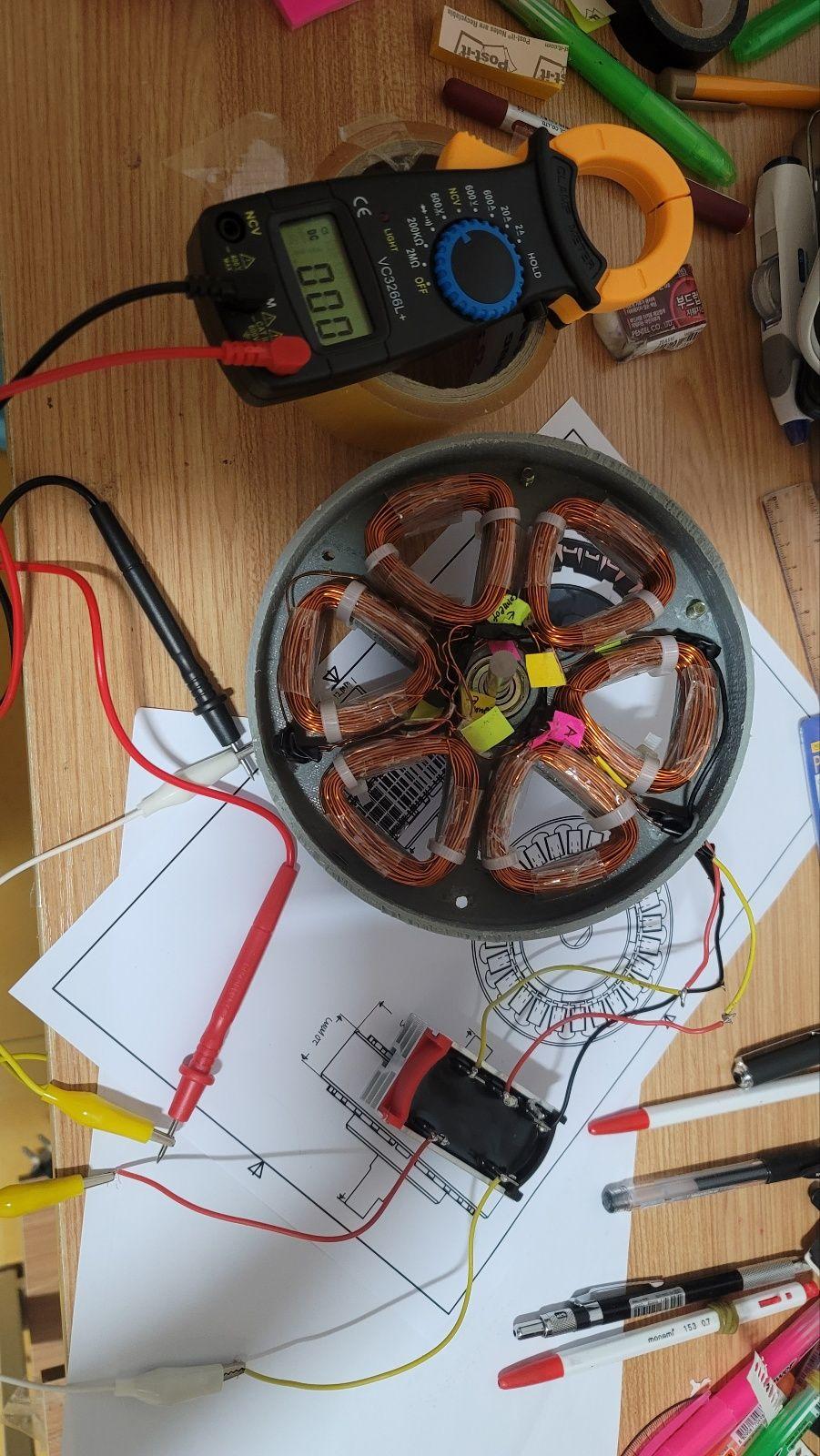

Step 10: Wiring the Motor Coil 1
This is the motor coil wiring diagram.
There are three phases in total: Phase A, Phase B, and Phase C.
The coil wiring is Y-connected.
This final line is also like this
Connect the coil.
ESC=>Speed ​​controller is 40A 4cell (rated voltage: 14.8v, 3.7v per cell)
Here, ESC converts direct current power into 3-phase power and excites each phase A, B, and C per hour.
It plays a role.
Step 11: Wiring the Motor Coil 2
Connect each coil Y according to the wiring diagram.

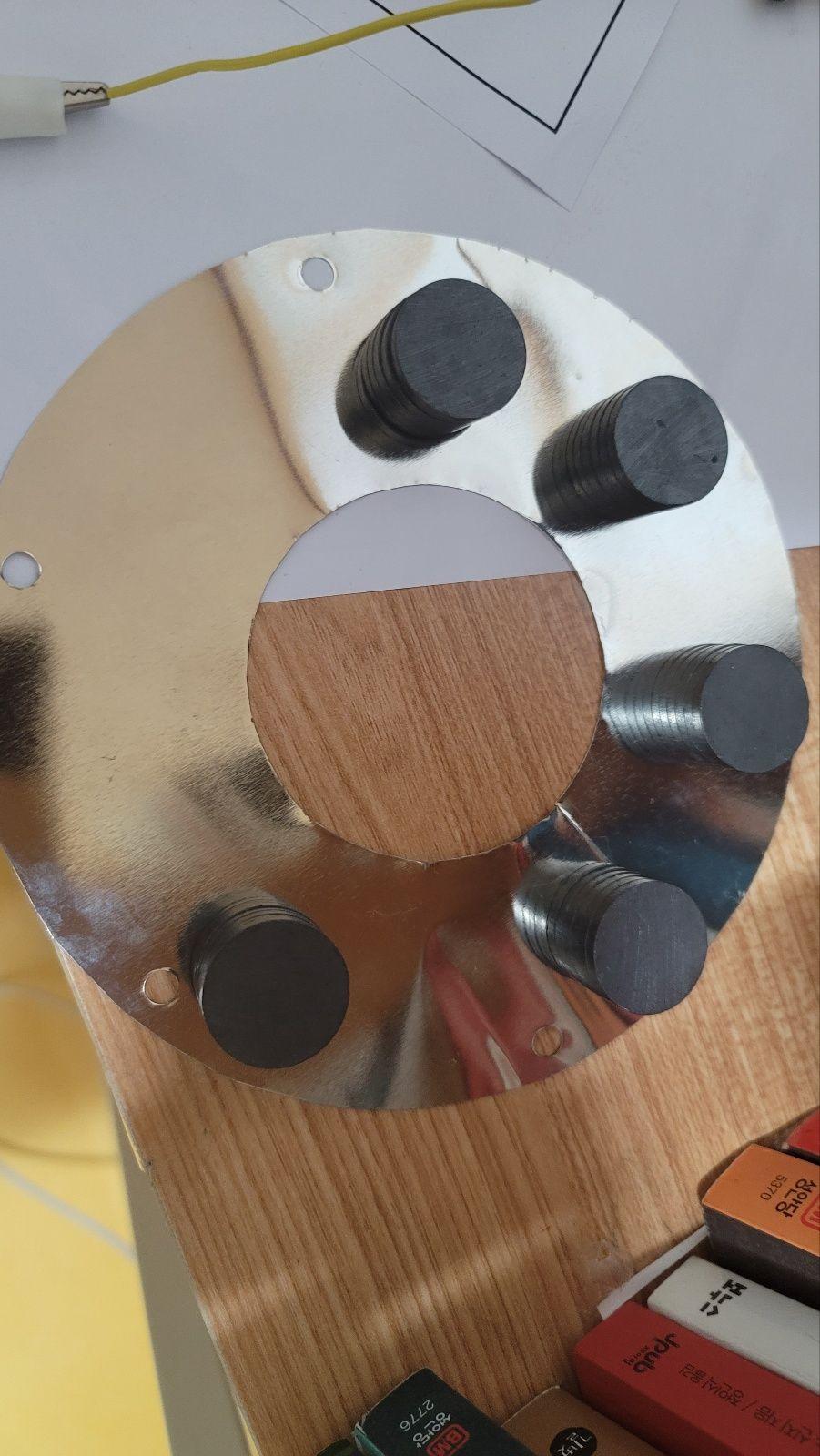

Step 12: Cutting Sheet Metal1

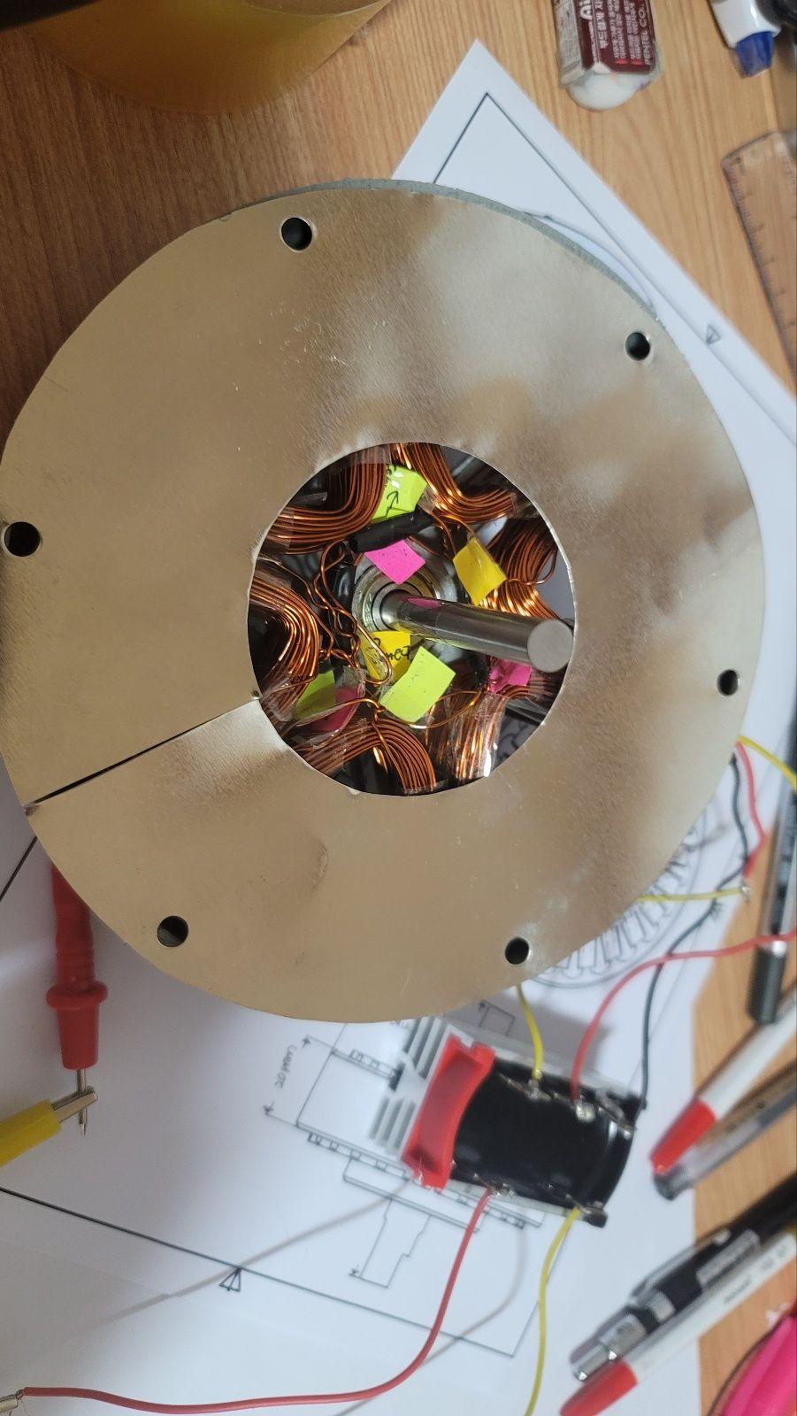

Cut the steel sheet into a circle to fix the magnet to the rotating part of the motor.
Step 13: Cutting Sheet Metal2
Bolt to a rotating part printed on a circular steel plate.
We conclude. Here, a punching machine is used on a circular steel plate.
Used to create bolt insertion holes.
Step 14: Cutting Sheet Metal3
Attach the prepared magnet to the circular iron plate.
Additionally, strong adhesive is applied.
Step 15: Check Coil Wiring Operation
Perform a continuity test with a hook-on meter or multimeter to check whether the coils are wired correctly and check the resistance value of each coil.

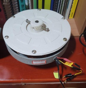

Step 16: Combine Each Printed Part.
Combine each printed part.
[Assembly]:
https://youtu.be/9-d7VQjLpJ8?si=UdKYsCsSL2245KDS
Step 17: Completion
completion ^^

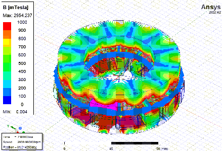

Step 19: Analyzing Electric Motor Electromagnetism
You can just skip this process.
If you have a program called ansys maxwell,
Try it as an experiment
