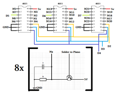

Step 1: The Touch Sensor
So I have experimented a lot with NPN transistors to achieve touch detection. When you touch Base pin of the NPN transistor, it lets the current thru. So I in this circuit we have a Capacitor(C), a Resistor(R) and a Transistor. The transistor am using is "BC547" NPN transistor which is pretty popular and easy to get.
I am using 0.47µF Capacitor, but 0.22µF and 1µF Capacitors also work. I have only tested electrolytic Capacitors, But feel free to try other types. If the capacity is too low, the capacitor wont be able filter the noise so we will get some distortion, but if the capacity is too high, we can get some delay which will be very annoying. if you use polarized capacitor (like electrolytic in my case) be sure to have negative pin of the capacitor towards GND.
So the tested values of R are 1MΩ and 100KΩ, so I will assume that all values between those will work. The resistor is connected to ground, and is pulling the output signal down. Whenever we touch the Base pin of the Transistor, it pulls the output high.
We are gonna be using 24 of these touch sensors for 24 piano keys. I just made 4 PCBs and each of them have 6 sensors.

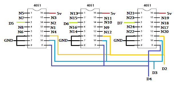

Step 3: CD4051 Multiplexing
Arduino nano has 14 digital pins, which of 2 are occupied by serial communication. 12 pins are not enough for 24 keys. that's why we have to use CD4051 Analog Multiplexer/Demultiplexer to increase the number of pins on the microcontroller. We need 3x CD4051 ICs, because each has 8 pins and we need total of 24. we have to use 24 of those transistor activated touch sensors. according to last step: connect transistor base to piano key, and each output of sensors to each pin(N1, N2, N3... N24) of the CD4051. D2, D3, D4, D5, D6 and D7 are connected to arduino's corresponding pins.

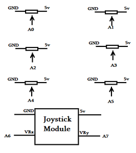

Step 5: Analog MIDI Controll
As shown on the image connect all GND and 5v pins. then connect potentiometer pins to arduino A0-A5 as shown. and X and Y to A6 and A7. 10K Potentiometers are recommended but up to 100K should work too.

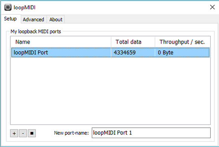

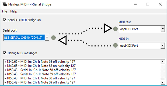

Step 7: Software
First you need to download hairless midi. Its a software that converts serial communication to MIDI. Download the version that suits your computer. Then you will need loopMIDI driver. install and open both hariless midi and loopMIDI. Be sure to upload the code to arduino first. Create new loopMIDI port and select your arduino's COM port in hairless midi. also select MIDI in and MIDI out of hairless midi to loopMIDI device. and finale you will need software like mixcraft or FL studio to use your MIDI device.
Oh and also don't forget to download the arduino midi library
