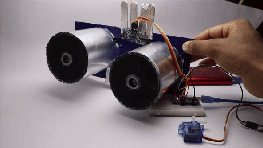

To give this big ultrasonic sensor a realistic look I will hand-paint the cardboard with a deep blue color.
The ultrasonic sensor also comes in dark green colour but I chose dark blue, Apply even layers of paint over the cardboard
If you are using a brown sheet of cardboard I would ask you to first paint it with white and later after the paint is dry you can color it with blue
For the crystal oscillator part that is present on the board of the ultrasonic sensor I will fold the cardboard into a small piece of box and later glue it with aluminum foil.
Trim the excess foil and after these parts are dry glue it to the main board using hot glue, Make sure none of the wires are hanging outside.
To make the pins i used popsicle sticks and covered those with aluminum foil to get that silver finish.

To test this ultrasonic sensor I used Arduino nano, microservo, few jumper wires and small piece of breadboard
You can find the codes online for this simple ultrasonic sensor and server control or simply use the arduino code given by me below
After you upload the code to the board just connect the wire to the ultrasonic sensor and servo as per the circuit diagram and place your hand in front of this ultrasonic sensor and now the servo should make a movement
There are many projects you can try to utilize the working of this ultrasonic sensor additionally you also can check the working of this ultrasonic sensor in the serial monitor of IDE.
