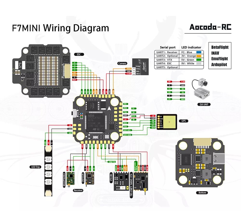

Step 3: Flight Controller and Receiver
After mounting the motors its time to mount the flight controller. stack come with plastic screws and spacers so i mounted the ese on the the frame first then soldered the motor wires on the ese key point always use flux and tin the new copper pads first before soldering the wires.
- solder all the 12 wires on to the ese polarity dose not matter the right direction can be later changed in betaflight configurator
- i also soldered Deans-T connector on ese or a xt60 it depends on your choice.
- install the cable connector come with stack on both ese and flight controller.
- i also soldered the receiver as per diagram provided with manufacturer.
- after everything make sure that nothing touches the frame because the fact that carbon fiber is conductive.
- wiring diagram is attached for reference.
