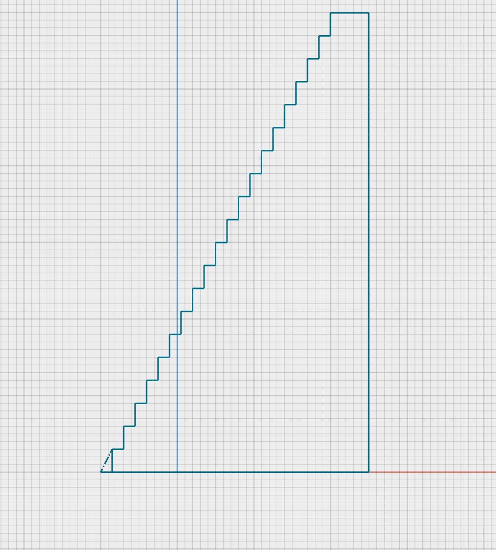

Step 7: Sphere (modeling)
I started by modeling my sketch. I started off by making a circle that has a 100mm diameter. I then created a line to cut the circle in half. I also added another cut 5/8ths through the circle. Then I revolved the sketch to make a sphere. Finally, I used the 5/8ths line to cut the bottom off. Next, I needed to figure out how to attach the lights.
Step 8: Lights (modeling)

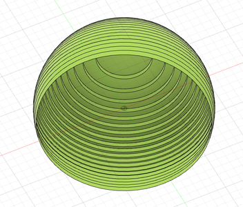

Now I needed to figure out how to add lights. If I just wrapped them around the sphere it would be very hard to keep them in place and it wouldn’t be controlled. I needed it to be controlled because it would look very ugly and very hard to code. As I was thinking of ideas I thought of creating lines like a staircase. However, as I made it I realized that the staircase idea would make it look like a cone and not a sphere. That’s because a sphere shape is curved so in certain parts it looks almost straight but then the higher you get it starts to curve inward. I then thought of another idea that could give perfectly horizontal lines and create a sphere.
Step 9: Lights_2 (modeling)
To do this I needed to cut the sphere. I planned on using a construction plane but I realized you can't pattern them which means it would take a lot of time to cut the model. Here’s a forum about it. I realized that I could pattern with surface tools. Surface modeling is another type of modeling in Fusion 360 which does 2d modeling instead of 3d modeling. I realized that I could use surface modeling as construction planes. This allowed me to pattern the surface as if it were a construction plane. I then cut the model to get small sections of a sphere.
Step 10: Lights_3 (modeling)
Now I needed to hollow out the inside and combine it with the real sphere. I started by extruding the cuts to where I got just the smooth edges. I then did that with all of the cuts and I ended up basically with a shell of a sphere. Finally, I combined it using the cut tool which showed the result I wanted. Basically a blocky sphere.
Summary of modeling lights
I basically needed to remove the smoothness on the sphere to make a controlled area for the LEDs to wrap around. What I did was make objects that were just the smoothness of the sphere. I then used that object to cut out of the central sphere to create a blocky and controlled sphere.

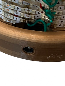

Finally, I added the rest of the stuff. That included a dome and a stand. I also hollowed out the sphere to reduce filament waste and give more space. I added holes for the plug and a place for the IR receiver could go. I was planning to have the IR receiver be exposed but I felt like that would ruin the aesthetic. I decided to have it hidden inside but close to the outside. Finally, I added a fillet on the top and bottom to make it more smooth.

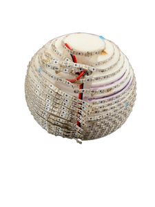

First I needed to cut the LEDs to length. Make sure that you are careful when cutting and only cut where the copper pads are. Next, I needed to get the number of LEDs on each row. Instead of counting each LED individually, I made a model in fusion that counts them for you. I got some of the dimensions and then I converted it to a 1:1 scale drawing. Once I printed it (on paper, not a 3d printer) I got an almost perfectly aligned replica that counted up to 40 LEDs. This made it a million times faster to count them. I then labeled them with what row they were and how many LEDs there were. I also recommend writing them down on a sheet of paper.
Step 18: Soldering_1 (assembly)
Now I needed to solder them. It took a very long time to solder them because the copper pads were so small and didn’t want to bond with the solder. I soldered 2 rows of metal wire that were positive and negative. To prevent short circuits I used hot glue as insulation. This was much cleaner than wires but took me a longer time because I was checking for shorts. I recommend you only do this if you have a multimeter to check for short circuits. You can check by using the resistance mode, placing one probe on positive and one on negative and if it shows 0 or beeps then that means you have a short. I also highly recommend you tin the data pads as I didn’t which made the 2nd soldering steps very hard.
Step 19: Glueing
Now we have to glue the LED strip. We are not going to solder the data pins yet because they are far apart but once the LEDs are mounted on the sphere then the LED's data pins are right next to each other. To glue this, I recommend using some CA glue with accelerator. Double check that you’ve written the number of LEDs on each level and remove the tape.

Step 22: Wiring/3d Model
Now we need to finish the wiring. You can follow the wiring diagram at the top. Then follow the pictures on how to insert all of the components. I recommend gluing the IR receiver and power connector. Finally you can glue the diffuser (white dome) to the base but I don’t think you need to.
