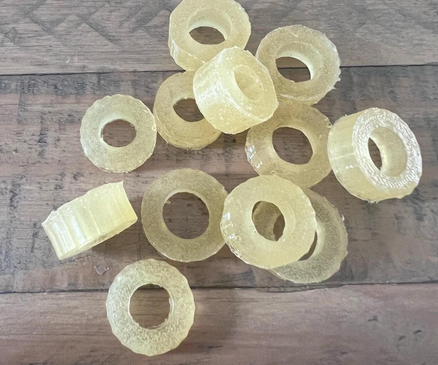

I also wanted to add something into the mold before i poured the resin to both give the centre of the wheel strength and to give me direction of where to drill the wholes to mount chain sprockets. I had these 3d printed and inserted them into the mold before closing it.
Once i knew how much resin i would need, the 3d printed insert was added and the two halves were fixed together i got to mixing the resin.
I used Xencast PX90 Hard Flexible Polyurethane Casting Resin (linked below) for the wheels as this gives a nice surface and isnt too hard when fully cured.
Like the silicone this stuff is super easy to use as it is a 1:1 ratio by either weight OR volume so essentially mix exactly the same amount of part A with part B.
If you want to add colour which i did with one of the wheels i poured part B into the cup and added the black pigment (also from easy composites). Mixed really well and then added part A. Once id mixed them both really well i began to pour slowly into the mold. The resin doesnt have a huge pot life meaning it will start curing pretty soon after mixing both parts so make sure you have everything set up and ready to before mixing the two parts.
