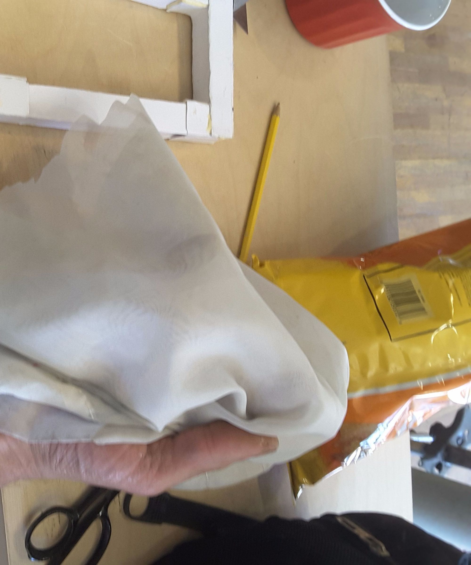

Step 8: Stretching the Screen.
I use sheer polyester mesh from the thrift store for a few bucks. It is usually about the same as 120 -200 mesh depending on the quality of the fabric. Cut a piece about an inch bigger than the frame all around. Wet the screen with water right before you stretch and the finished screen will tighten up as the mesh dries. Start with one side and put a staple into the center and ends , anchoring the mesh. Repeat on the opposite side while pulling the screen taut. Then do the other parallel sides the same way. Next , on the original side , pull the fabric tight and staple in between the first anchors. Go all the way around the framend, pulling and stapling until the screen is secure. I leave no more than about a1/4 inch between staples.

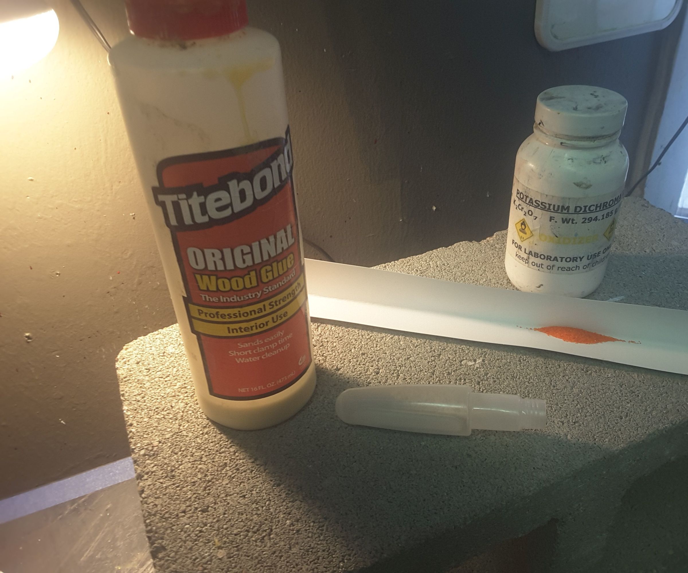

Step 9: Coating the Screen With Emulsion.
Emulsion is the light sensitive material that will make the printable stencil used to print. It must be applied and dried in darkness. While wet, during the act of coating, indirect indoor light is acceptable as the emulsion dries, it must be stored in complete darkness. I use the bathroom outfitted with a fan and space heater for this step . I made a light proof bag from opaque scrim material to store the screens once dry.
