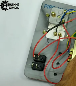

After soldering all the components to PCB, connect one input wire of the transformer to switch and the other wire to the left side of the female socket as shown below.
  • Then connect the audio socket to the PVC Sheet, solder black wire of PCB to Black audio-video socket.
  • Solder the red wire of PCB to an SPST Switch, solder a wire to another point of same SPST switch, then solder it to the red audio-video socket
Step 5: )
  • Solder 5mm yellow LED with 1k resistor to the positive and negative leg of Audio/Video jack.
  • Connect 7805 voltage regulator ic with cooling fan and do all other connection of cooling fan and 7805 ic to audio/video jack and SPST switch as shown in below images.
Step 6: )
  • Connect the Green Positive wire of RED led with 1k resistor to the SPST switch as shown below, connect the yellow negative wire of red led to the negative terminal of audio/video socket.
  • And BOOM! All the connections are done, it's time to cover the body with another PVC sheet.
Step 7: )
Connect the 12V Lead Acid Battery to the inverter, & your Inverter is now Ready to power up your Small Ac appliances.
