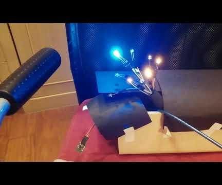

In many hotels, there are “do not disturb” notices hanging on the door to make sure the hotel workers do not accidentally bother guests. I decided to extend the idea and create a version for students since when students are working on projects, they are often interrupted by parents or siblings; other times, when students are asleep, their family might unintentionally get in the room, disturbing their sleep; this machine keeps others away when you do not want their accompany using Ir remote. There are five modes: very busy, busy, doing unimportant things, you are welcome(let everyone in), or sleeping.

Link the circuits same as above. It does not matter if you don’t use Arduino Uno as above, as I also use Arduino Leonardo; as long as the effects are the same, it does not matter. I didn't draw it but be sure the LEDs need to be separated from the board, like the picture above. The five LEDs aligned together are the LED lights that will appear outside; the two LEDs aligned (yellow and white) together, are the LEDs inside. The black thing on the side is the IR receiver. I connected the Arduino board with the portable battery charger (charged) to provide the energy needed to power the machine using the USB transfer line. You can change the pin where you want the LED lights or the IR receiver to be, but make sure not to use D2 and D3, as it is actually the same with SDA and SDL (used in LCD board). It will confuse the machine and don't make it function.
Step 2: Software
I code my machine in a way so if I press the upper button of the IR remote, the red LED will shine, the words "very busy don't disturb will appear on the LCD board." When pressing the OK button of the IR remote, the yellow LED will shine, the words "very busy don't disturb"will appear on the LCD board. When pressing 3 of the IR remote, "not busy" will appear, and the green LED will shine. Pressing 4 means white light will go on and the words "Welcome!" will appear. At last, when pressing 5, the blue light will go on and the words: "sleeping" will appear.
When you successfully press a button and change your condition (the light), the white LED in your room will glow. When you press meaningless buttons for example * , the yellow LED light in your room will grow.
