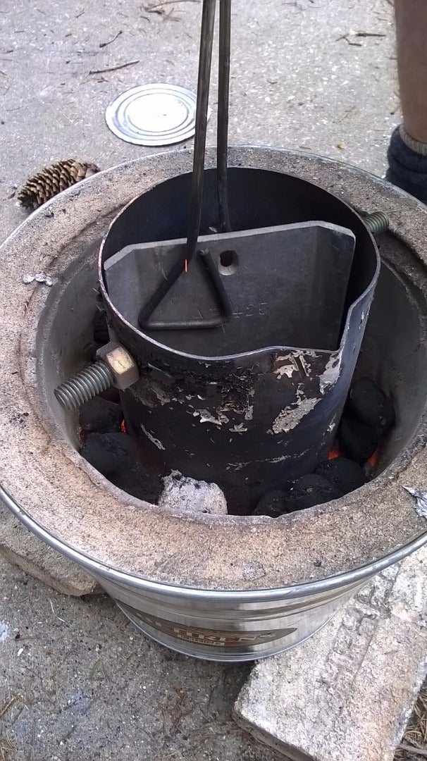

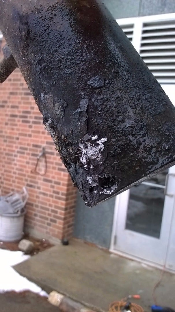

I am sure there are plenty of instructables on how to melt aluminum so I will let you find an appropriate one for your own needs. I suggest making the crucible out of an old fire extinguisher. The first crucible was made out of an empty propane container but the steel was too thin, and the aluminum spilled out during our first melt.
Melt a bunch of aluminum scrap and form a bar that is large enough to house your toy. Make sure to get rid of all the slag before pouring, or pour through a steel mesh.
Once the bar solidifies and cools pop it out of its mould.

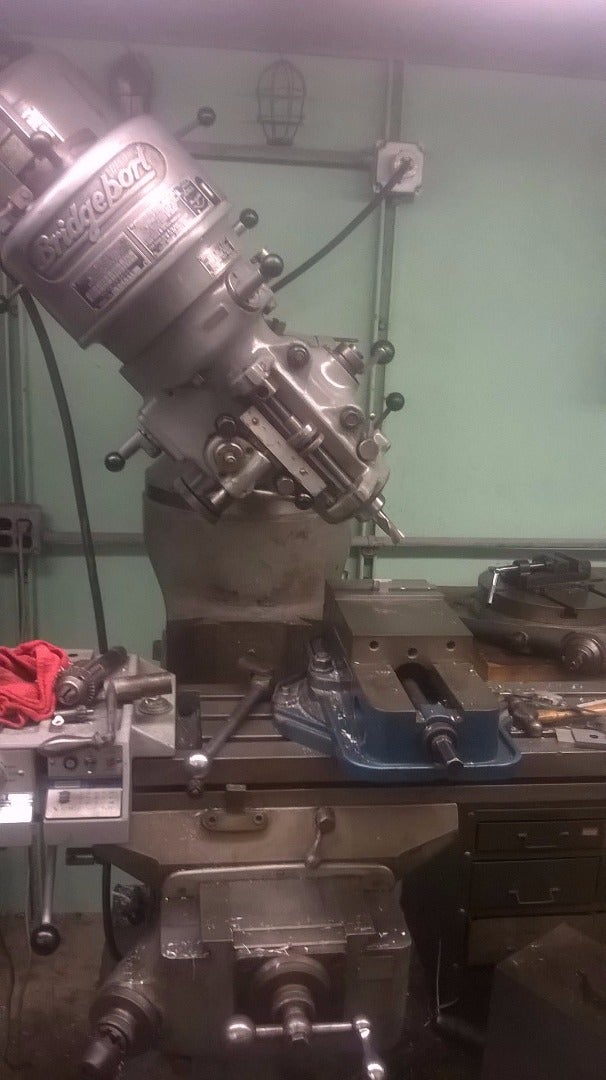

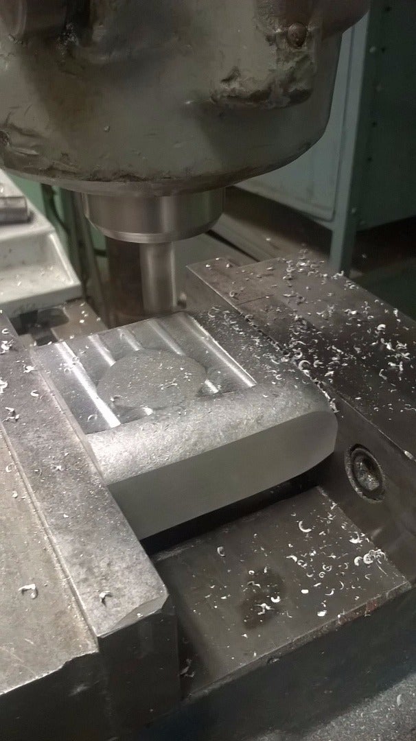

Step 3: Milling
- First I used a bandsaw to cut one of the bars into a rough square. I checked to make sure the aluminum didnt have any bubbles or slag.
- Then, using a regular end-mill I created all 6 sides of the rectangular prism, leaving some of the natural surface of the bar so you could see it was smelted.
- I also but the 2 grooves with a regular end-mill and then went through them with a key seat cutter to make the sliding notches.
- After this I created the two shuttles and the handle to make up the sliding mechanism.

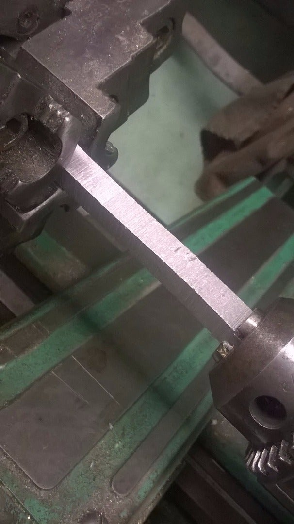

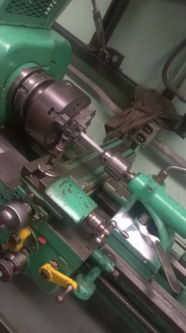

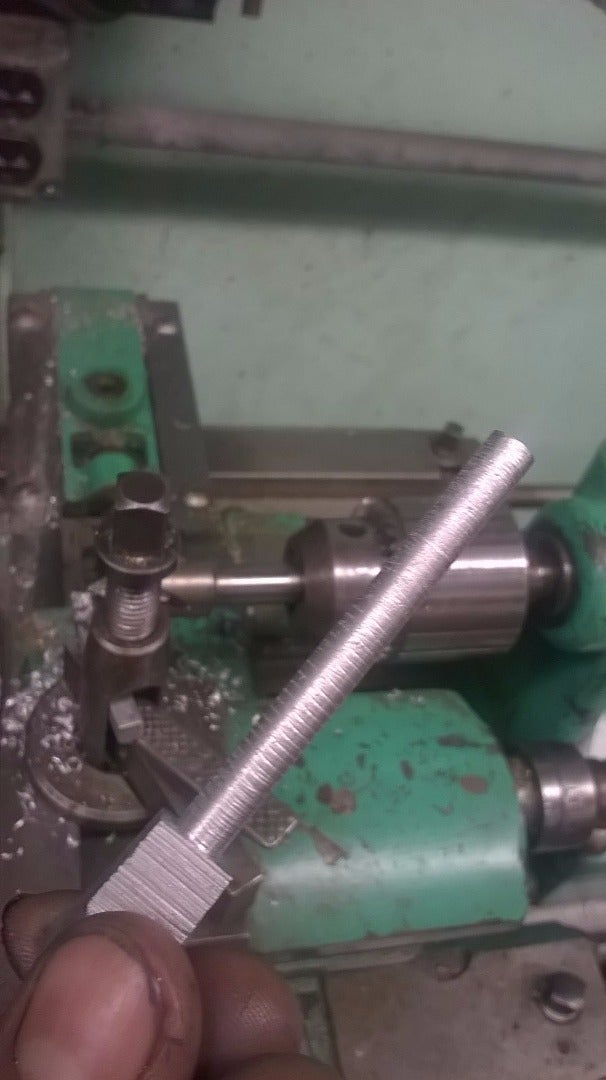

- I turned a thin piece of aluminum in a lath to make a 1/4 inch rod. I polished it and then cut it into 3 lengths.
- I then tapped two of the rods on both ends and one of them on one end.
- I drilled holes in the shuttles and the handle, tapping the out-most hole on the handle and on the two shuttles.
- lastly I creating two small aluminum disks and tapped them to create two small nuts.
- After assembling the toy I polished all the machined edges.
