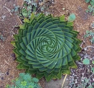

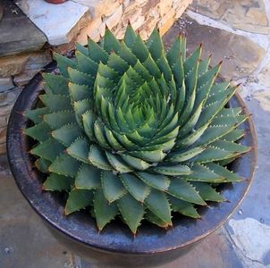

Nature is awesome! There are tons of things that we can not explain in an easy way, like the hidden patterns that are a constant in many different organisms in completely different environments. Things without an obvious relationship or connection but behave in the same specific way.
Scientist have to use their most powerful tool to explain this behavior, and that is Mathematics. When using "math lenses" you can describe these complex patterns with constants, and there is one that shines above them all (at least in nature behavior) and it´s called the Golden ratio. I have uploaded pictures of plants which patterns can be described with this constant.

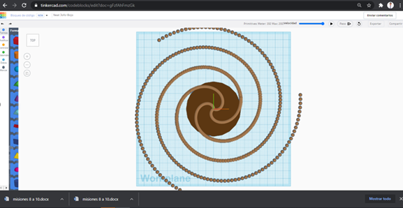

But its enough to simulate a sunflower, and the result is awesome, as the real sunflower is. --- Check the second image.

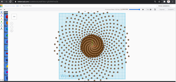

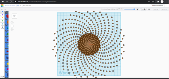

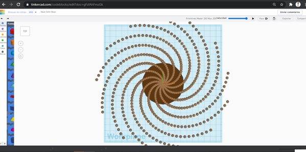

We can set irrational numbers with a fraction approximation. With a small web search we can find the most famous famous constants related to math and nature. Please check the image and use the irrational numbers to see what other pattern of seeds distribution you can achieve, and why the golden ratio is the best over all. Use this approximations to set the Radio variable.
To overcome the 200 blocks overflow, I ran the code three times with a set "Radio" (irrational number) with a different ranges (0 to 150, 151 to 300, 301 to 450) and took pictures of every result. Then used power point to remove the background of the seeds and overlap them. That gave me the opportunity to watch the distribution in a wider range. The resulting four images are shown (Euler, square root of two, Ln2 and Feigembaum constant).
