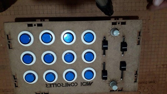

In this tutorial we will take in charge the hardware part and we will create a Controller keyboard which has 12 push buttons for digital control and 6 potentiometers for an analog control so it is obvious that all the buttons will be used to display the notes and the potentiometers will control things like sound volume tone etc.

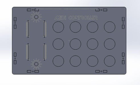

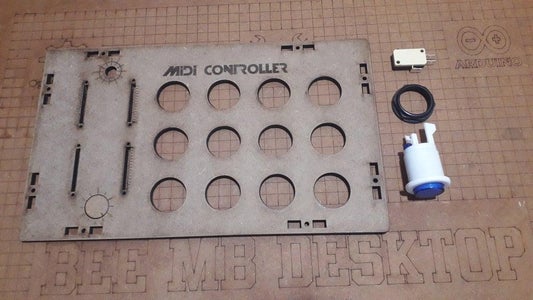

We have all these controllers connected to an Arduino Nano board which has all the necessary I/O pins to hold these inputs together, and through its USB connector it will be easy to send instructions from the controller to the software side. For sure in order to make a better appearance for our MIDI controller, I have designed this box considering the size for the push buttons and the potentiometers and through a CNC laser cutting process I can produced the designed parts for my project.

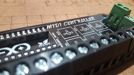

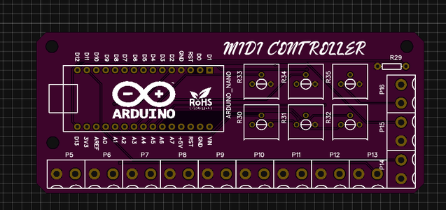

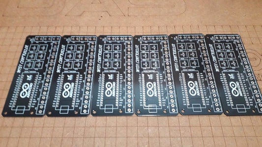

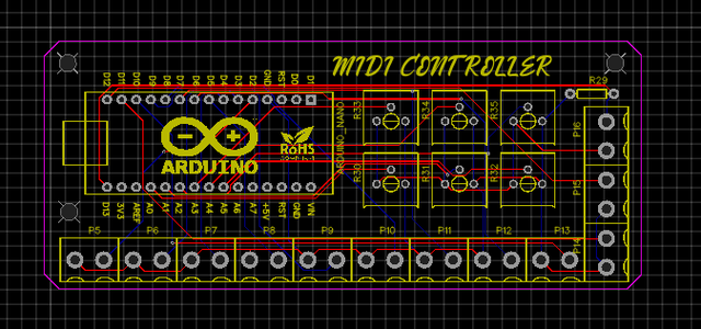

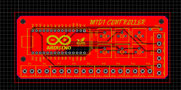

Step 4: The Circuit Board Making
Talking electronics

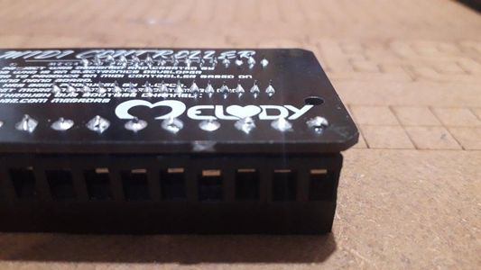

After making the circuit diagram I transformed it into a PCB design to produce it, in order to produce the circuit board, I set some parameters like the PCB thickness color and quantity.
As you can see in the pictures above the PCB is very well manufactured and I’ve got the same PCB design that we’ve made for our main board and all the labels and logos are there to guide me during the soldering steps.

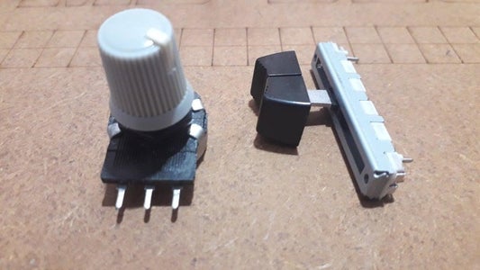

- 4 Slide potentiometers : https://amzn.to/2WjS51Y
- 2 rotory potentiometers : https://amzn.to/2WjS51Y

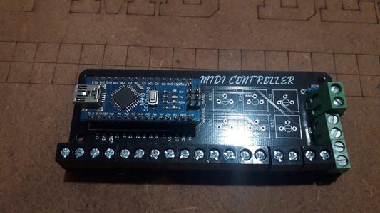

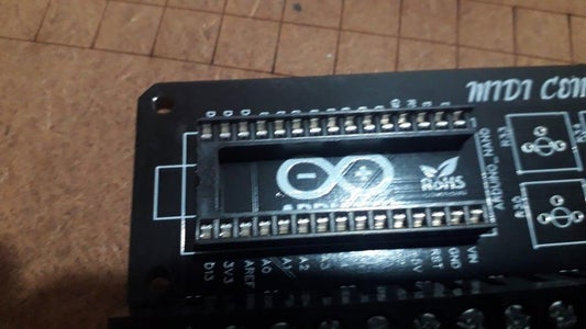

Step 6: Electronics Assembly
Now everything is ready so let’s start soldering our electronic components to the PCB and to do so we need a soldering iron and a solder core wire.
Safety first
Soldering Iron
- Never touch the element of the soldering iron....400°C!
- Hold wires to be heated with tweezers or clamps.
- Keep the cleaning sponge wet during use.
- Always return the soldering iron to its stand when not in use.
- Never put it down on the workbench.
- Turn unit off and unplug when not in use.
As you can see, using this PCB is so easy without forgetting the labels that will guide you guys while soldering each component because you will find on the top silk layer a label of each component indicating its placement on the board and this way you will be 100% sure that you will not make any soldering mistakes.
I’ve soldered each component to its placement and you can use both sides of the PCB to solder your electronic components.

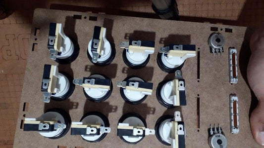

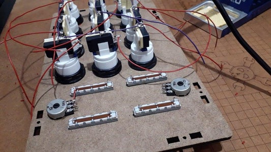

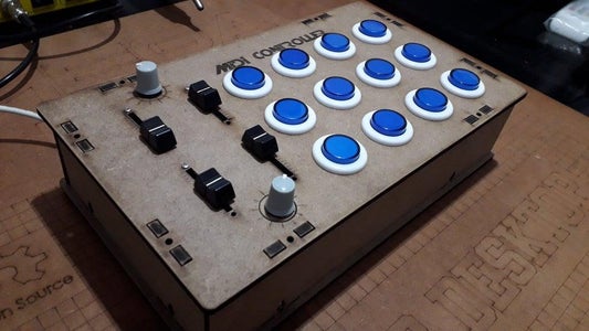

Step 7: Hardware Assembly

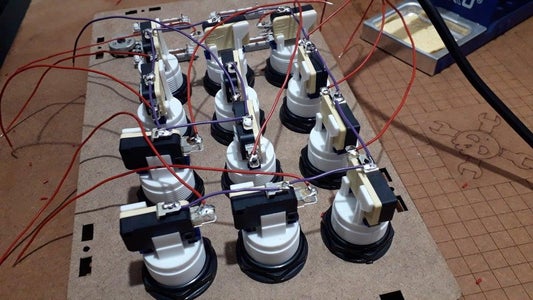

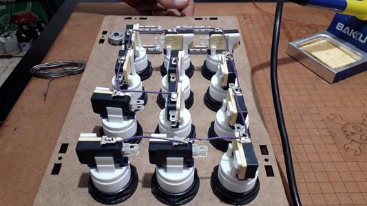

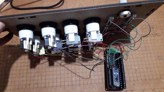

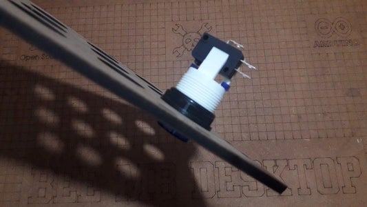

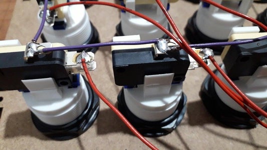

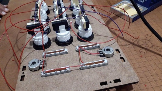

Now we have the PCB ready and all the components soldered very well, Now we need to place the push buttons each one to its placement in the top side of the bow, it will be so handy placing these push buttons. After that we screw the slider potentiometers and the same for the rotary potentiometers too, and do not forget to put the potentiometers cavers so using theme will be easier for you.
After that we need to solder some wires in order to connect these controllers to the board. In case you faced any difficulties while soldering these wires, just get back to the circuit diagram where it is clear how to place these wires, It is not that much hard sure if you follow the same circuit diagram, you will have in the end all the push buttons input wires just screw them to them header connectors on the board and do the same for the potentiometers, last but no least we take the lower base of our box and we screw the PCB in it. Ok so after placing the board in its placement all what we need to do now is finishing the assembly of the box and we finished the hardware part.

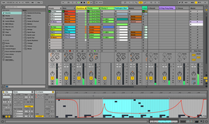

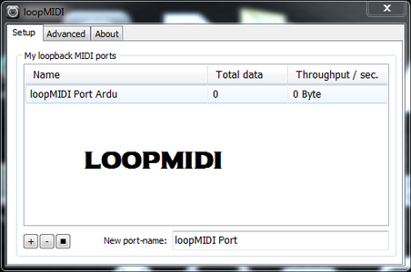

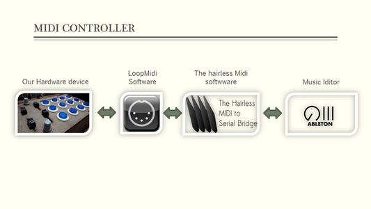

About the music editor, I use Ableton software, but how to link this software to the Arduino instructions that will be sent through the serial port! It is easy since I use loopMidi sotware to create the Midi port in which our Arduino is connected, and another software which is hairless-midiserial which will receive the arduino instructions and convert theme to midi instructions and then send them to Ableton.
So first things first we run loop midi and we create a new midi port by giving it a new name.
Then we move to hairless-midiserial and we select the com port of our Arduino, and as you see once you select the right com port the Arduino start sending serial commands, in the other side we select the midi port that we have created, then we move to Ableton’s settings and under preferences we activate the external input controller device.
The last step is mapping the controller functionalities, by selecting what each button should control, it is so simple, just select the function in Ableton and press the desired button in your controller and it will be mapped.
And once you finish that, you can start playing with your new MIDI controller.
