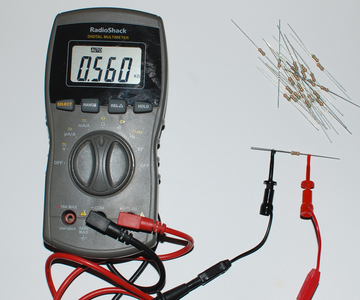

I just bought a bunch of 560 Ohm gold band resistors from a local surplus store. They were a nickel each. Is it possible to make millions of parts, sell them so cheap, and maintain the +/- 5% tolerance specified by the gold band? The tool used to answer this question is Statistical Process Control (SPC).

A bunch of resistors the same value. (I measured thirty)
The spreadsheet template located in step five.

The CP and the CPK are both a long way above 1.3, these resistors are within the specified tolerance with plenty of room to spare.
