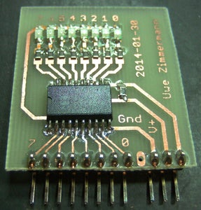

Attached you will find a 1:1 PDF of the circuit board I designed in Eagle, as well as the Eagle-files. As described above I did the layout using SMD components - apart from the pin-header.
I produced the first batch of the circuit boards using the toner-transfer technique - already extensively described here on Instructables, e.g. PCB making guide. Based on my own experience and the tip from my students, the glossy photo paper available at the Swedish chain Biltema works best.
Because it is quite a small board I could fit 28 boards on a single A4 sheet of photo paper. The first batch was manufactured on a piece of circuit board big enough to fit 8 individual boards. The etching went well and I separated the individual boards afterwards. On each board I then have to drill the 13 holes for the pin-header - with my illuminated drill stand.

After having drilled the holes for the pin-header, it was time to pick up the parts for the complete device. Since I had to do the soldering by hand for now, I started by plating each of the right-hand side pads for the LEDs with tin using the soldering iron.
The next step is to put one LED after the other onto the board, pressing it down while heating up the tin on the pad so that it flows around and under the contact surface of the 1206 package. Of course you should make sure you put the LEDs in the correct direction into the circuit, i.e. with the cathode facing to the common GND connection.
After all LEDs were in place I did the same for the eight 330Ω resistors and the 33kΩ resistor.
In order to solder the TSSOP20 package of the chip onto the board you should start by placing some tin onto opposite corners of the footprint. Then you press down the chip onto the board while heating up these two pins sequentially. Then you go from one of the other pins to the next and solder each pin to its pad. For this you press the pin down onto the pad with the tip of your soldering iron and once pin and pad are hot enough you add a small amount of solder.

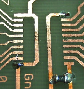

Step 5: Correcting the Mistake
Taking all those photos for this instructable I made two mistakes while soldering the devices onto the board. First I forgot to attach one side of all the 330Ω resistors, which I normally would have done before soldering the chip and the pin-header. But this was not the worst thing.
Before I started soldering, I checked in which direction I had to solder in the LEDs. The cathodes of these LEDs is marked with a small green dot on the top of the 1206 package. These dots should of course point to the common GND connection of all LEDs. Well, putting it short, they didn't in the end, none of them.
So I had to desolder all LEDs, turn them around 180 degrees and solder them again onto the board.
Finally everything was in place, I tested the circuit and it works. Now I am waiting for the ordered parts for the next 10 boards.
