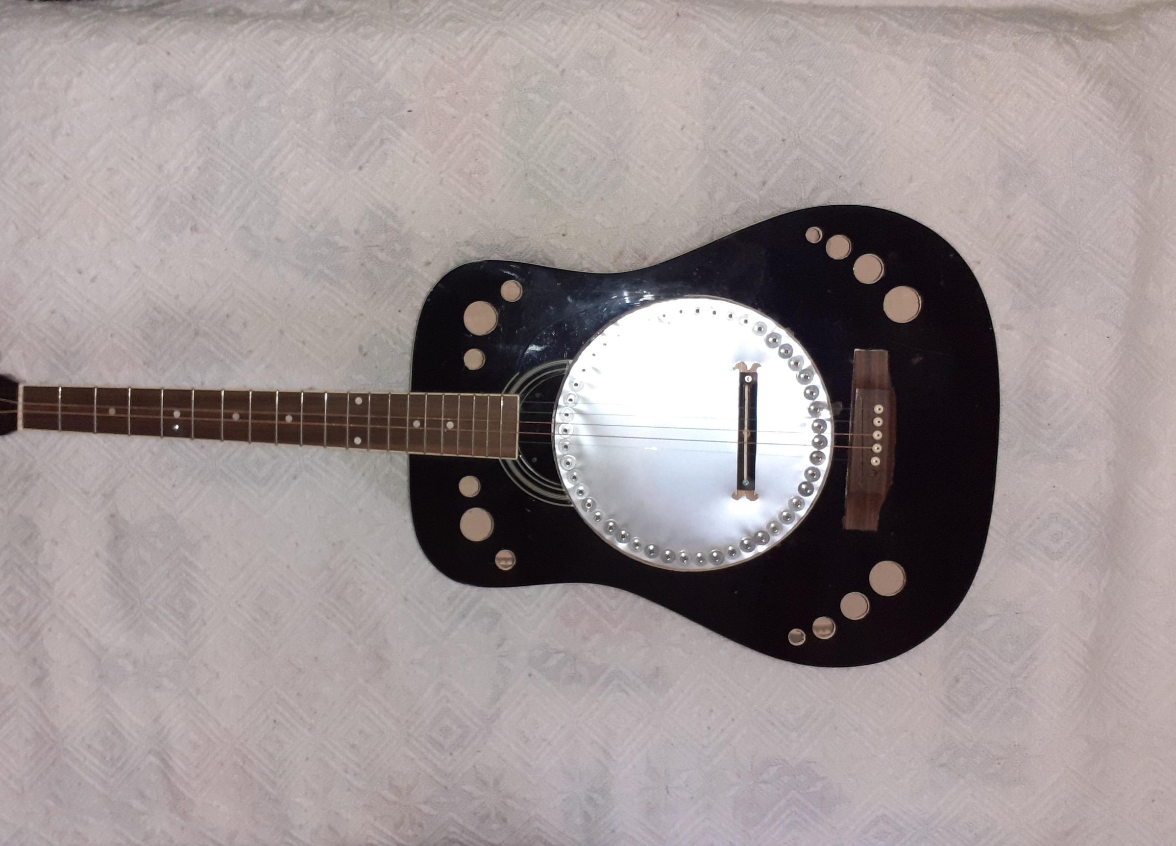

I was given a destroyed folk guitar. As you see, the bridge was seriously brocken, and the wooden acoustic table was unglued inside the sound box just under the bridge. But the neck was straight and usable. I decided to keep the neck and the sound box, and to use a pan lid as a resonator.
1x old destroyed guitar in end of life (folk guitar in my case) for the body
1x Stainless steel pan lid (diameter = 31 cm in my case) for the resonator
1x IKEA Grünka (stainless steel) spatula for the tailpiece
2x 15x25x500mm empty aluminum (or wood) bars for the reinforcing of the body
Aluminum sheets (thickness 2mm, 1,-mm + M4 and M6 nuts+ Waschers + M4 and M6 Screws , screws + epoxy glue: see text
Tools : hand saw, hand drill, drill bits, files

Step 6: Mounting
1 - Mount the bridge on the resonator without the string cover with the M6 countersunk screw + washer + nylstop M6 nut. In my case, I got slight vibrations at the bridge level, so I added a circular piece of leather (diameter 7cm + a d= 6 mm hole in the center) between the bridge and the resonator . I's all fine, now
2- Mount this assembly in the guitar hole
3- Mount the tail piece
4- Mount the strings (I mounted bronze strings 12-54) , and then mount the string cover over the bridge. Pay attention to the length of the strings when you buy them because they are a bit longer as the usual standard.

Step 8: Conclusion
This project took me about two complete working days (without glue drying hours).
Now the question: how does this guitar sound?
This guitar doesn't sound like a dobro guitar and you won't be able to play great slides.
This guitar does'nt sound like a banjo
This guitar does not sound like a cigar box guitar, because there is still a sound box below the resonator.
This guitar also does not sound like a usual folk guitar because the resonator is not made of wood.
In fact, the sound is difficult to describe:
On the one hand, there is less roundness than in a wooden guitar with an acoustic wooden top, but on the other hand, it sounds with a metallic overtone, with fairly pure bass and treble sounds, but with a long envelope. It's quite original.
In order to improve the sound volume level (which is currently quite acceptable as it is), I think I will add two holes in the sound box (like in dobro guitars) in the future.
