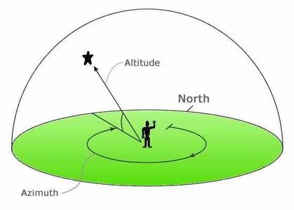

I´ve been searching and ther´s almost nothing on the internet about how to make a homemade dobsonian telescope scale, so I decided to make one myself so all of you that have a dobsonian classic telescope can make one and improve your skills in astronomy.
This is very useful if you have some software that tells you the coordenates of altitude and azimuth.

Now, you need two scales one for altitude (up and down) and one for azimuth (left and right) so we need to print them in the type of materials of your chice, in my case I chose a kind of plastic that is strong and flexible.

Step 5: Orientate the Telescope
So now that you have your telescope in place it´s time toorientate it. You have to put the 0º pointing to the north and the 180º pointing to south.
And in the altitude scale you have to have the 0º when the telescope is exactly horizontal and the 90º when the telescope is exactly vertical.
Now you can look to the coordinates of the objects you want to see.
