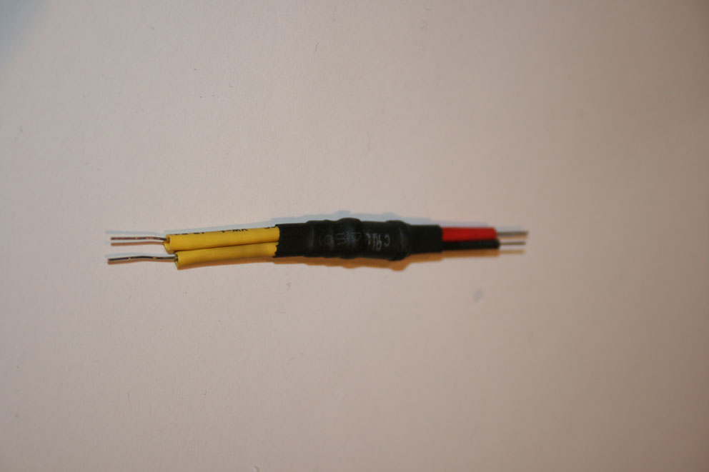

Now the board looks like it has woodworm, you can heat up the soldering iron.
Start off with the resistors (Lowest profile part first). They don't need to be in any particular orientation, but make sure the right value resistors go in the right places.
Next comes the socket for the chip. This needs to go with the notch towards the led. This gives a visual indication of which way round the Attiny goes when you're finished.
After that is nicely soldered down, you can add the led. On my boards, I lay the leds flat against the board, but depending on how you are going to use them, you might want to stand them up.
Finally, you can solder the header pins in place.
It wasn't intentional, but it turns out there is just enough space between the pins and the chip to fit the board onto a breadboard. Lucky, eh?
