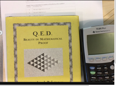

1. Document Camera - I use it every day as a wireless document camera. Either in the front of class or I bring it directly to my students seat. We review student work, answer keys, calculators and other manipulatives as they are projected on the Smartboard. I use the app IPCamera as it requires no software on my computer and has a good quality picture. It also includes some useful options and an automatic switch to "landscape" by just tilting the stand. The stand also works well with an AppleTV by using Airplay. The best app for this is from IPEVO called iDocCam which makes an iPhone into a document camera and has many useful features (such as pinch to zoom).

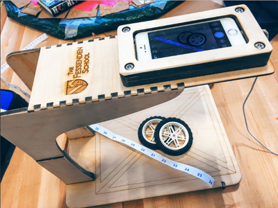

Step 9: Assemble IPhone Layers, Insert IPhone and Bolt to Top Plate.
Laminate the iPhone holding layers with spray adhesive and insert phone in top plate. Bolt in place. The iPhone will charge in the stand and should not need to be removed. I recently added an LED light so the stand can be used in a dark classroom or auditorium.

Wireless set up as a document camera.
