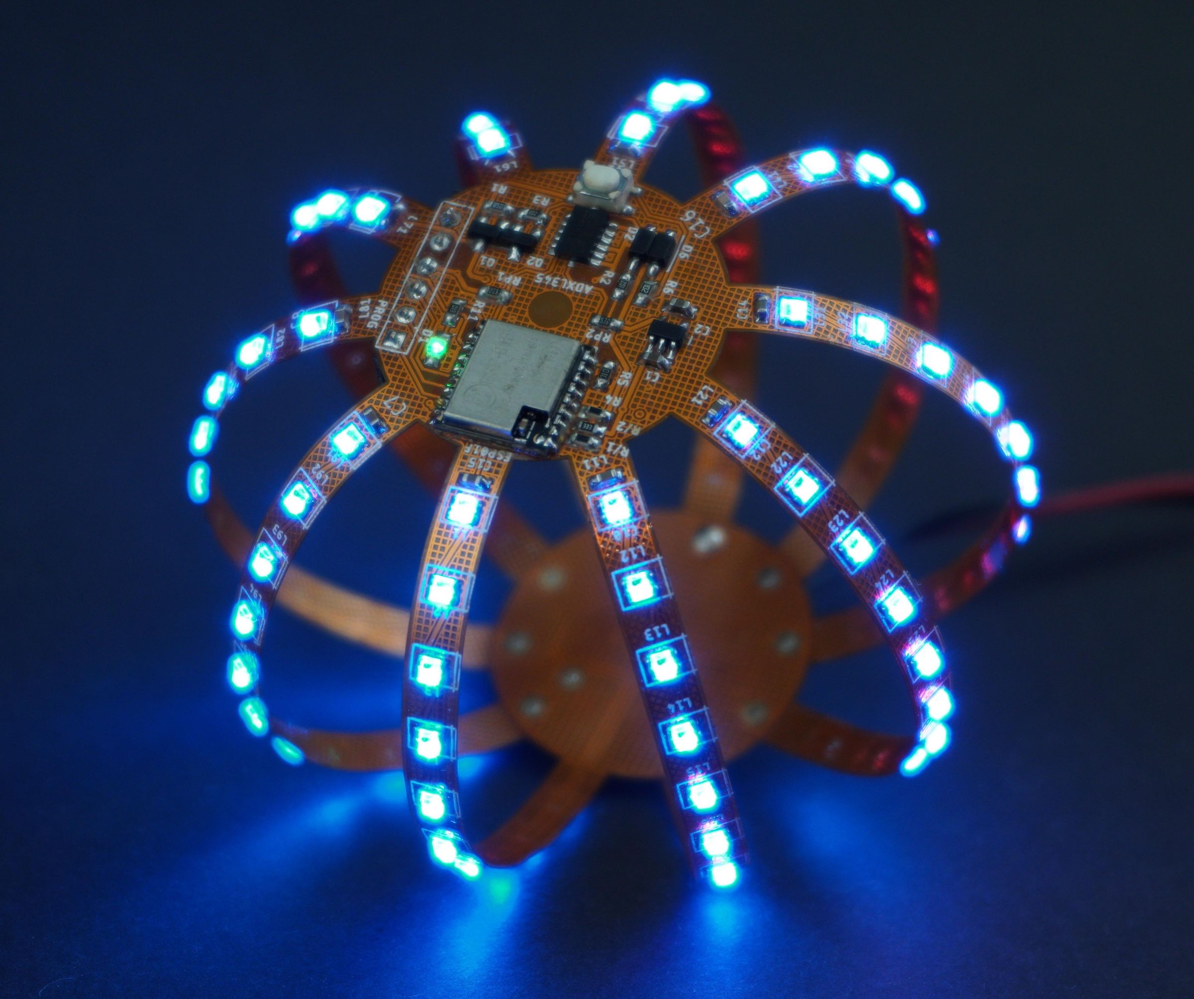

All the lights of the Dodecagon Light are controlled by the simple and small Wemos D1 mini microcontroller which contains a powerful ESP8266. The WiFi connection allows me to connect the light to my current home automation service. The microcontroller is possible to switch the main lights (light bulbs) which are connected in parallel by a 5V relay. The color lights (WS2812) are controlled by only one digital output pin. They are grouped in triplets and connected in parallel by a small three wire cable. The WS2812 strips have double sided tape on their backside so it is very easy to get these strips to the twelve small vertically wood pieces.
The circuit board and the 5V power supply are mounted with some screws to the base plate. The circuit board has four terminals for 5V power in, the WS2812 LED strip, the mains lights switch and for an optional temperature sensor. The temperature sensor is only required for my home automation and not for the light itself. All the schematics are shown in the picture above.
The last picture shows the control unit in the Home app on the iPhone. These instructable does not focus on the home automation service Homebridge but when you are interested in this I will write an own tutorial for this. If you just want to have a look how this can be done then have a look at these instructions or these.
