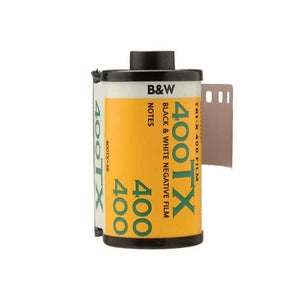

  4. Kodak Tri-X 400 Black White Film

  4. Use Kodak Tri-X 400 Black White Film and rotate film using the knob to capture pictures using the manual shutter, and send the film to chemically process after film is finished.
