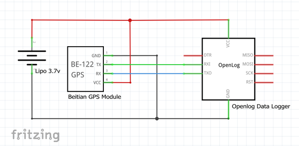

When designing a new system, I thought about the building blocks that I would require to collect the data. I would need a GPS receiver to locate the position, a microprocessor to collect this data, an SD card for storage and a battery to power the units.
I had a sort through the parts I could find in my workshop and came up with the following items.
  • GPS receiver
  • Microprocessor
  • Data storage
  • Battery power
Now, although this may have worked, it was not a very practical design for my dog to carry as it was too bulky. There are guidelines for researchers who track animals in the wild and the recommendation is that the device should not weigh more than 5% of the animal’s body weight (Kenward, 2001). Of course, I did not want the device to hinder my dog, so I looked at ways to minimise the weight and bulk of the design. After research, I identified a tiny GPS receiver that weighed 3g. It just requires a power supply and when it has a 3D fix (latitude, longitude and elevation) for its location, it flashes a red light. The Arduino and SD card reader were replaced by a single package that would take the data from the GPS receiver over a serial connection and log the data to the card automatically. It had its own microprocessor (ATMega328) on board that would manage this feature as it had been pre-loaded with the code to do it automatically, so there is no need to write any code for this project to work.
The final component was a power supply and I found a lipo battery that had been used in a toy drone that I had managed to crash. A quick search online found an even smaller package that should be able to provide the necessary power for a decent length of time (I thought >60 minutes should be enough).

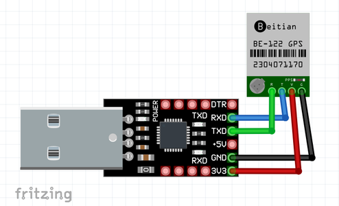

The receiver needs to be connected to the computer via a serial port, so the easiest way to do this is to use an FTDI device with a USB connection.
The circuit is very simple to wire up. Once plugged into the computer, the device takes a bit of time to get a fix on its location and will start to flash its red LED once it starts transmitting data over its serial port.
Load the u-center software and configure the settings. The connection will be through one of the COM ports and the baud rate for this particular device is 38400 baud.

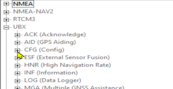

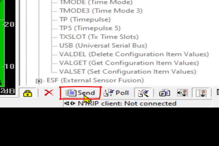

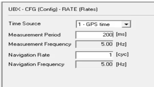

The default sample rate for the receiver is 1Hz, so it takes a sample of my location every second. This rate would be fine if I was using it to track myself but I wanted to track my spaniel, who darts backwards and forwards quickly. I decided to change the sample rate to 5Hz to see how that worked.
Fortunately, the u-center software allows us to communicate with our device and it is easy to change the settings whilst it is still connected.

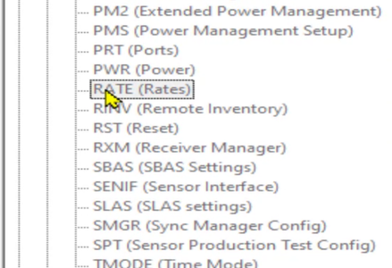

From the top menu bar, choose view --> messages view.
Then choose the config --> rate.
The measurement period needs to be set to 200 milliseconds, which will give a sample rate of 5Hz. Don’t forget to SEND these settings to the serial port using the button at the bottom. If you look at the animation panels, you can see the refresh rate has now changed as they are updating faster.

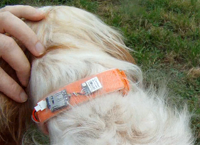

Step 7: Final Build
The connections are quite simple, so I soldered the wires and plugged in the battery to give it a final check. The receiver is working as the LED is flashing, and so is the data logger.
I used one of those cheap light-up collars that has a flashing LED that lights up a tube inside the double layer of the collar material. I originally thought I would place all of the components inside this collar to keep them protected, but it was a bit too fiddly to thread them inside. As I wanted easy access to the battery connector and also be able to remove the SD card, I decided to encase the components inside some heatshrink instead. I had already adjusted the collar so that it was a good fit for my dog, and then I laid out the components onto the collar to check they would all fit.
A bit of clear heatshrink completed the task, but I just had to cut some slots to access the battery connection and aid removal of the SD card.

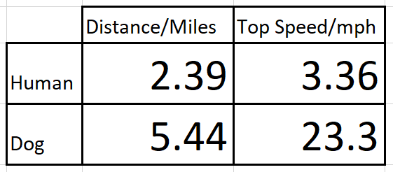

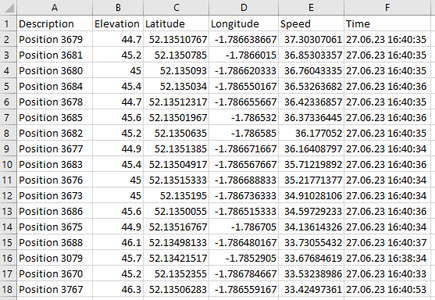

This data can also be exported as a CSV file. I saved it and loaded it into a spreadsheet. From there it is easy to sort the data on a column and I found that Lucy had a top speed of 37 km/h (23.3 mph).
So, to summarise, let’s look at the statistics for human versus dog.
My dog travels at least twice as far as I do and her top speed is about 7 times faster than my walking pace.
