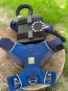

Step 4: The Encasing
I used fusion 360 to design an encasing for the DogBit. It is too small to contain all of the cables so to cable to power the breadboard power supply sticks out as well as the LEDs and the stepcounter. I used a 3D printer to make this encasing, it's printed from PLA.
you can find the file here.
