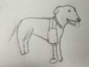

Step 1: Create Sketch
Create your game plan to create your prosthetic. This step give the outline to follow for the rest of your project.

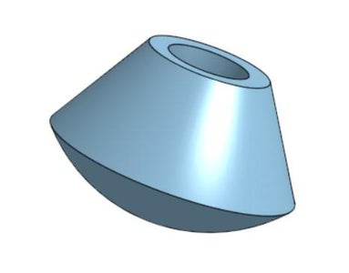

Step 3: 3D Design and Print
Make your foot and connector of the prosthetic in your choice of 3D design program, I used OnShape. Make these pieces according to the measurements. Upload your pieces to the printer and set the to print. My whole print took about two and a half hours.
