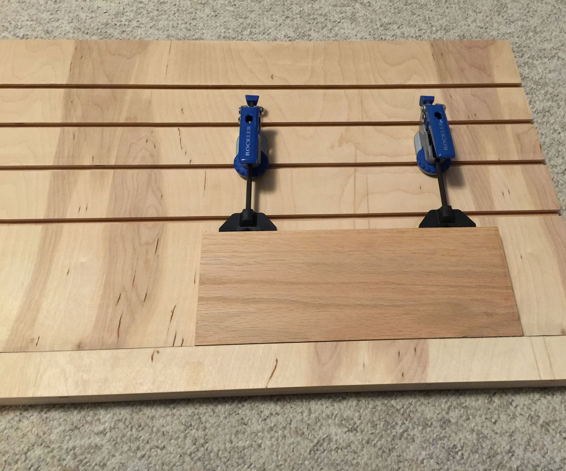

Step 3: Trim and Assemble
I cut the ends of the ramp flush with a flush trim router bit.
