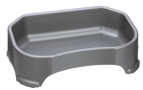

(1) Extra Large Water Bowl for Dogs (1.25 Gallon) https://www.amazon.com/dp/B085Y4ZV1K?psc=1&ref=ppx...

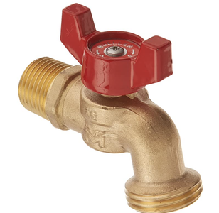

(1) 1/2" Hose Bibb https://www.amazon.com/dp/B08T1HQ37Q?psc=1&ref=pp...
Step 1:
First, remove the waterspout of the beverage dispenser and connect the hose bibb to the dispenser.
Step 2:
In the second step, drill a hole through the water bowl and fit the water float valve through the hole, with the ball facing inside the bowl.
Step 3:
Next, connect the hose to the water float valve, and tighten to seal the hole.
Step 4:
After, connect the other end of the hose to the hose bibb that is attached to the water dispenser.
