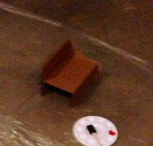

Step 6: Painting Booth Bench
Items Needed:
- Sponge paint brushes (1 inch and 3 inch)
- Crafter's paint tray
- a Bottle of red acrylic crafter's paint
- Fully structured booth bench (x 2) - created in the previous step
To get the look of the "Cherry Garden" restaurant, we chose our main colors to be red and green, with metallic highlights. There isn't much to this step other than painting the bench red. (If your kids are doing the painting, garbage bags make good paint smocks).
Start by squeezing red paint onto your crafter's paint tray. Dip the sponge brush into the paint on the tray. While holding the fully structured booth bench by the underside support piece, paint the entire exterior of the bench red.
Items Created:
- Painted booth bench (x 2)
