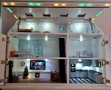

Pic 1. Christmas lights on the facias of my 1960's Doll House, lights on the Christmas tree and a festive film on the SMART TV.
Pic 2. Side view of the lights on my 1960's Doll House.
Pic 3. Front view of the Christmas Lights with the roof closed dowm.

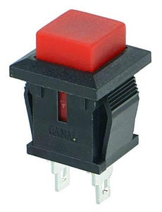

Pic 2. 12mm Mounting Hole Red Square Latching Push Switch https://amzn.eu/d/hYh0g3B 1 off
Pic 3. 12mm Mounting Hole Red Square Non Latching Push Switch https://amzn.eu/d/aX0Imk1 1 off

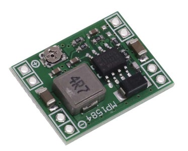

MP1584EN ultra Small DC-DC 3A power Step-Down regulator set at 1.5v 1 off

The solar control box has it's control circuit left in place with a MP1584EN ultra Small DC-DC 3A power Step-Down regulator (set at 1.5v) hot melt glued to the case.
The 1.5v output from the regulator is wired in place of the battery. The LED string is soldered back on the PCB once it has been run around the doll's house brackets. Cut a short length off to wrap around the tree.

A doll's house momentary push switch is connected across the mode switch so the lighting modes can be adjusted from the top of the house.

Pic 3. MP1584EN adjust the output to 1.5v.

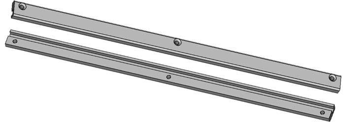

Pic 1. The LED string is run around the facia of the Doll House contained is a series of 3D printed brackets held in place with M2 countersunk screws. Fix the brackets in the position shown in this pic. Note holes are drilled through the front facia left and right so the light string can be run through from the left facia to the front and into the right facia.
The brackets are printed in clear filament and are of four different types.
Pic 2. Angled hole drilled for the LED string through the facia.

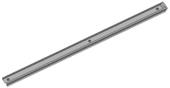

Pic 3. Run a pair of wires from the LED string output on the lighting module PCB. This wire comes out through the switch mount bar (into a short length of LED bracket) and into the first left hand XmasLightsBracket200 where it is jointed with solder to the LED light string. Leave a short length of wire slack to allow the roof to open.
Pic 4. Bracket type 1 is "XmasLightsBracket200", 5 off required 1 for each side and 2 for the front.
Cut down one length of this bracket to cover the wire on the switch bar see Pic 3.
Pic 5. Bracket type 2 is "XmasLigtsBracketFrontR200", 2 off required for the front of the roof. Not the stop end on the right. Note mirror one bracket in CURA end on so a stop end is on the left.
Pic 6. Bracket type 3 is "XmasLigtsBracketLeft184", 2 off required for left and right of roof. One end has a bevel to match the pitch of the roof. Note one bracket will need to be mirrored in CURA down it's side to fit on the right of the roof.
Pic 7.Bracket type 4 " XmasLigtsFrontMid", 1 off required center front.
