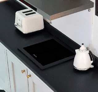

Pic 1 & 2. The Hob has touch controlled rings that light when touched or if a metal pan in put down on a ring.
Pic 3. The circuit uses 4 off TP223 capacitive touch sensitive modules that light an LED under each hob ring when touched. Touching a ring again will turn it off.

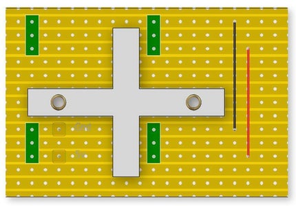

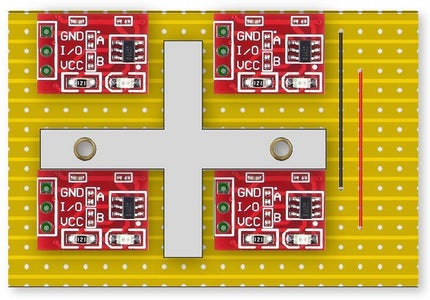

Pic 1. The location of the touch modules on the Vero Board
Pic 2. Same view but with the touch modules removed to show the "KitHobVeroSpacer" part and the mounting connectors for the touch modules.
Pic 3. This is the rear of the Vero board

Pic 1 diagram D on all four touch modules solder link across B contact pads and solder a 40mm length of wire to the touch contact pad. On the other end of these four wires solder a M2 solder tag.
Pic 1 diagram C insert a M2 bolt, M2 washer, solder tag with wire (see above) and a Nyloc Nut in each of the four holes in the "HobSurface" 3D part.
Pic 1 diagram B insert touch modules into the sockets on the Vero Board. With two M2 bolts fix 3D part "KitHobSpacerVero" to the top of the Vero Board (bolt from the rear of the board).

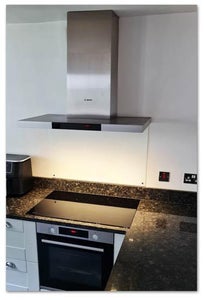

Pic 1. The chimney type extractor fan is based around the Bosch model I have in my kitchen Pic 2 and 3.
I have fitted an LED down light to illuminate the hob as per the original. A strip of overhead projector paper is also illuminated my this LED to act as the LED control panel.

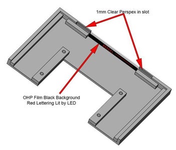

Pic 2. Print the OHP label (pic. 4) and place in the slot in the "ExtractorLower". Add a small piece of Perspex into the slot in front of the label.
Screw the "ExtractorLower" to the ExtractorDiffuser" with M2 self tappers. The "ExtractorChimney" and "ExtractorDiffCap" are glued to the "ExtractorLower".
