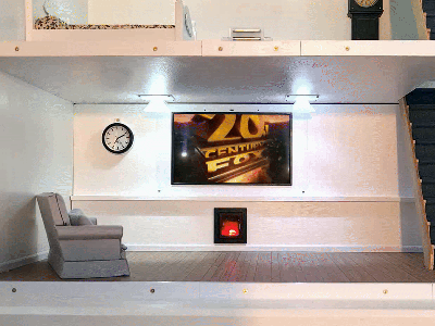

This is a fully functioning Smart TV scaled up it would be around 60". Based on a Google Nest Hub the TV is voice controlled and can play TV channels off the internet, videos, content cast from your mobile phone, play music or show pictures.
Note the Google Nest Hub uses it's own power supply and is seperate from the power to the house.

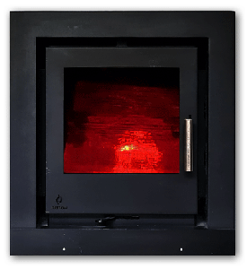

In my house I have a wood burning stove below my TV. I have designed a 1/12th scaled version to fit in the Doll House and fitted a fire effect LED to light it up.

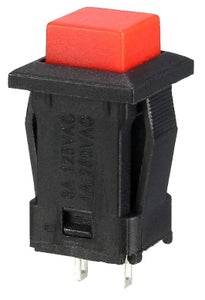

Pic 3. 12mm Mounting Hole Red Square Latching Push Switch https://amzn.eu/d/hYh0g3B 2 off

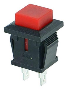

Pic 4. Pic 3. 12mm Mounting Hole Red Square Non Latching Push Switch https://amzn.eu/d/aX0Imk1 1 off

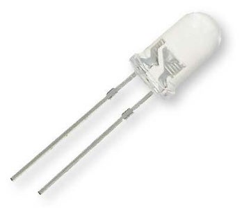

Pic 5. Flickering LED 1 off

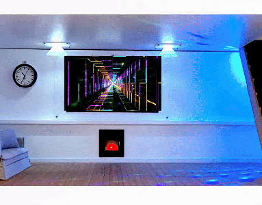

Pic 1. This image shows the lounge of my 1960s house. The TV is mounted on the wall with a mantel shelf below it. The wood burning stove is fitted in a brick recess under the mantel shelf. I don't have a sound to light in my lounge :), but thought it would be a nice addition to the Doll House.
Pic 2. On the Doll House a 12mm plywood supporting wall is contructed with cut outs to house the TV, wood burner and sound to light module. The completed structure is inserted into the rear of the Doll House by 87mm. This will give the space required to fit the Google nest Hub.

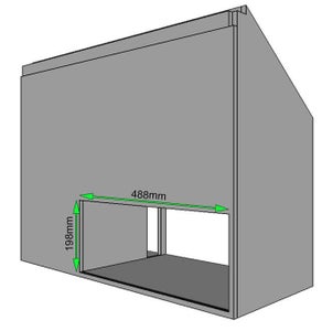

Pic 4. The rear cutout with demensions.
Pic 5. The completed rear wall structure is inserted from the rear of the doll house and measures 487mm to 197mm and it can be removed if required for maintenance.

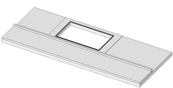

Pic 1. The main wall is cut from the 12mm thick plywood lounge wall of the house and cut down to 487x197.
Fix a 71mm length of 6mm ply to the bottom and then a 11.5x5mm baton on top of that to make the mantel shelf.

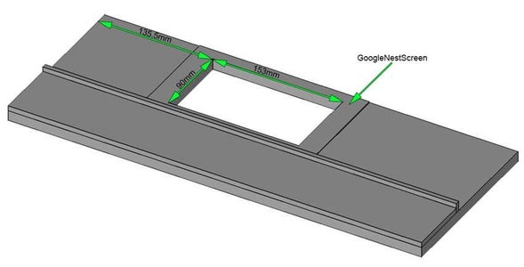

Pic 2. The panel needs a cutout to take the Google Home screen. Cut a hole 153mm x 90mm in the panel. The hole is 135.5mm from the left edge.

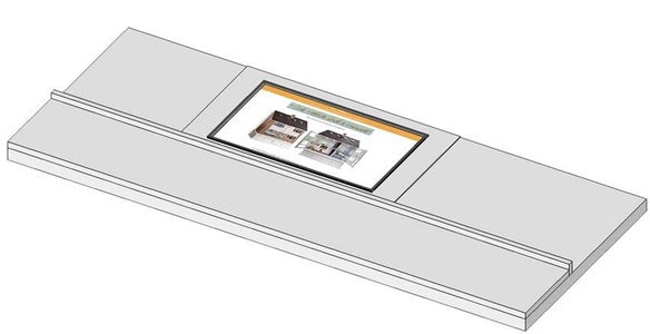

Pic 3. Over the cutout fit the 3D printed part "GoogleNestScreen" to cover the edge of the hole and screen.
This is printed/painted white to match the wall.

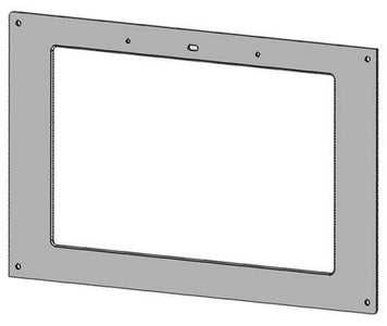

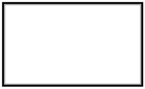

Pic 4. The 3D part GoogleNestBezel is then super glued over the top to form the "edge of the TV screen".
This part is printed/painted in black and makes it look more like a LCD TV.
Pic 5. This image shows the 3D part GoogleNestBezel in place
Pic 6. Google Nest Hub in place behind the bezel.

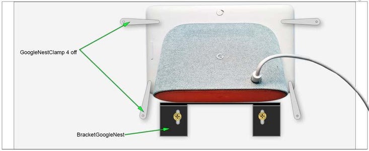

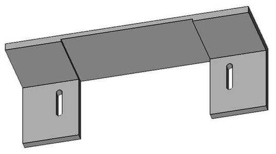

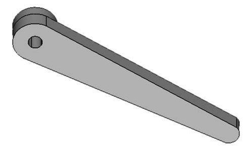

Pic 1. The Nest Hub sits behind the cutout and bezal and sits on a small 3D printed shelf and is locked in place by 3D printed clamps.
Pic 3. Screw the 3D printed part BracketGoogleNest on the rear of the cutout so the Nest screen lines up with the bezal.
The bracket is slotted to allow some adjustment.
Pic 4. Screw the four 3D printed GoogleNestClamps in place using Pic 2 as a guide. The clamps twist and lock the Nest Hun in place.

Pic 1. The woodburner sits below the Google Nest Home.
Pic 2. The wood burning stove has a flicker effect LED set into 3D printed logs.

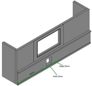

Pic 3. Cut a hole through the 6mm & 12mm plywood of 39mm x 35mm.
Cut the hole 192mm in from the left edge of the wall and 15mm up from the floor.
Pic 4. Print out some logs in clear 3D filament. Glue them together around the LED inside the fire.
Paint some black shading onto the logs to represent non burning parts.
The Red LED flickers at random to give a fire effect.
Pic 5. Assemble the Wood Burning Stove with the logs inside using super glue.
