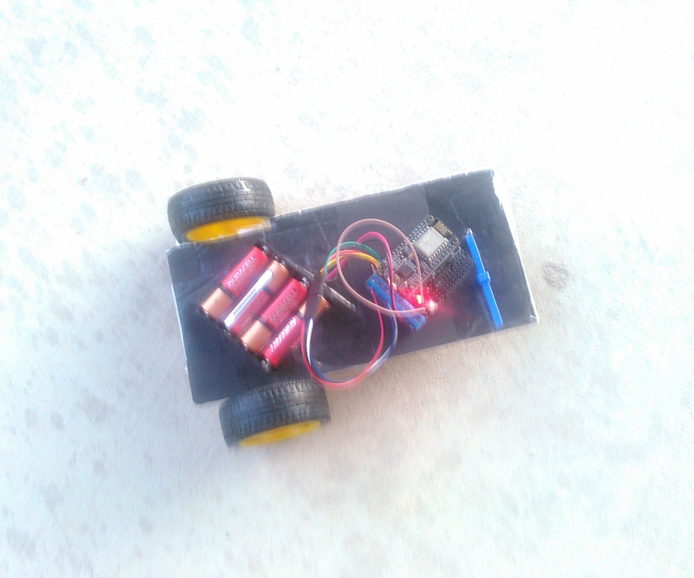

Step 2: Using Foam Board for Chassis
As stated in the introduction I have used foam boards for robots for many years now. They work well with legos as you can use a pencil to "drill" a hole so that you can connect beams above and below the foam board which happens to be about the same thickness as a beam. However, with zip ties, legos aren't necessary. You can connect many items to foam boards with simple tools that most students have access to.
Step 3: Using Wooden Plank for Chassis
To use the wooden plank, you will need to drill holes.. however, these will be more durable than the styrofoam or foam boards.
Once holes are drilled, then it is simply a matter of attaching components with zip ties.
Step 4: Using Styrofoam Circle As Chassis
Using styrofoam as a chassis enables students to quickly prototype as it is easy to make holes for attaching components, however is more easily damaged than foam boards and wooden planks. However they seem to be much lighter than other solutions.
Another bonus is the ability to carve out niches so that components fit snugly. Combining these circles with foam boards help improve durability.
This robot was built in about 10 minutes from start to finish. I used an ESP8266 board with a NodeMCU motor controller. Since I was using servos, I did not need really need this, but it does take in 6-12 volts and supplies the microcontroller with 3.3 volts that it needs.
I used ESP8266 Basic to program it.
