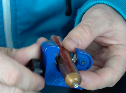

Evaporator-drier for a refrigerator (25 g)
Liquid
Step 1:
To start, I want to show you what’s inside a refrigerator drier. It contains granules like these, which absorb liquid very well. For example, if you pour water into them, it will evaporate five times faster than if you just pour it into a glass. This is a great idea for building today’s burner and improving its efficiency.

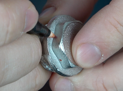

We drill six holes in the lid. First, I make 1 mm holes, and then I enlarge them with a drill bit of the appropriate size to match the outer diameter of the copper tube.

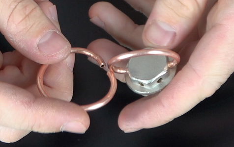

We make three rings from copper tubing. Each ring should have a slightly larger diameter than the previous one. Then, we fix them in place as shown in the video. Please watch the video for more detailed instructions so you can understand how to properly press the tubes into place.

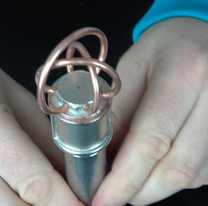

We assemble the capsule, insulate it, and apply high-temperature silicone to the threads. Then, we securely tighten the cap and proceed with the first testing.

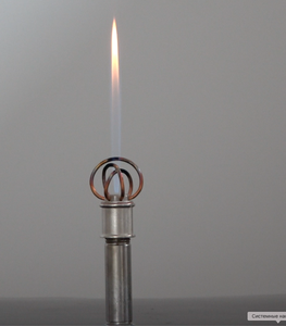

This burner can operate in different modes and with varying flame intensities. For example, if you close the tubular dome, the evaporation will occur much faster, and by creating high pressure, the flame will become turbocharged and reach very high temperatures. If you spread out the dome, the flame will be of lower temperature but thin, long, and beautiful. It’s up to you to choose the flame temperature and shape according to your needs. This will also affect the burn time: the higher the flame temperature and turbocharging, the shorter the burn time.
