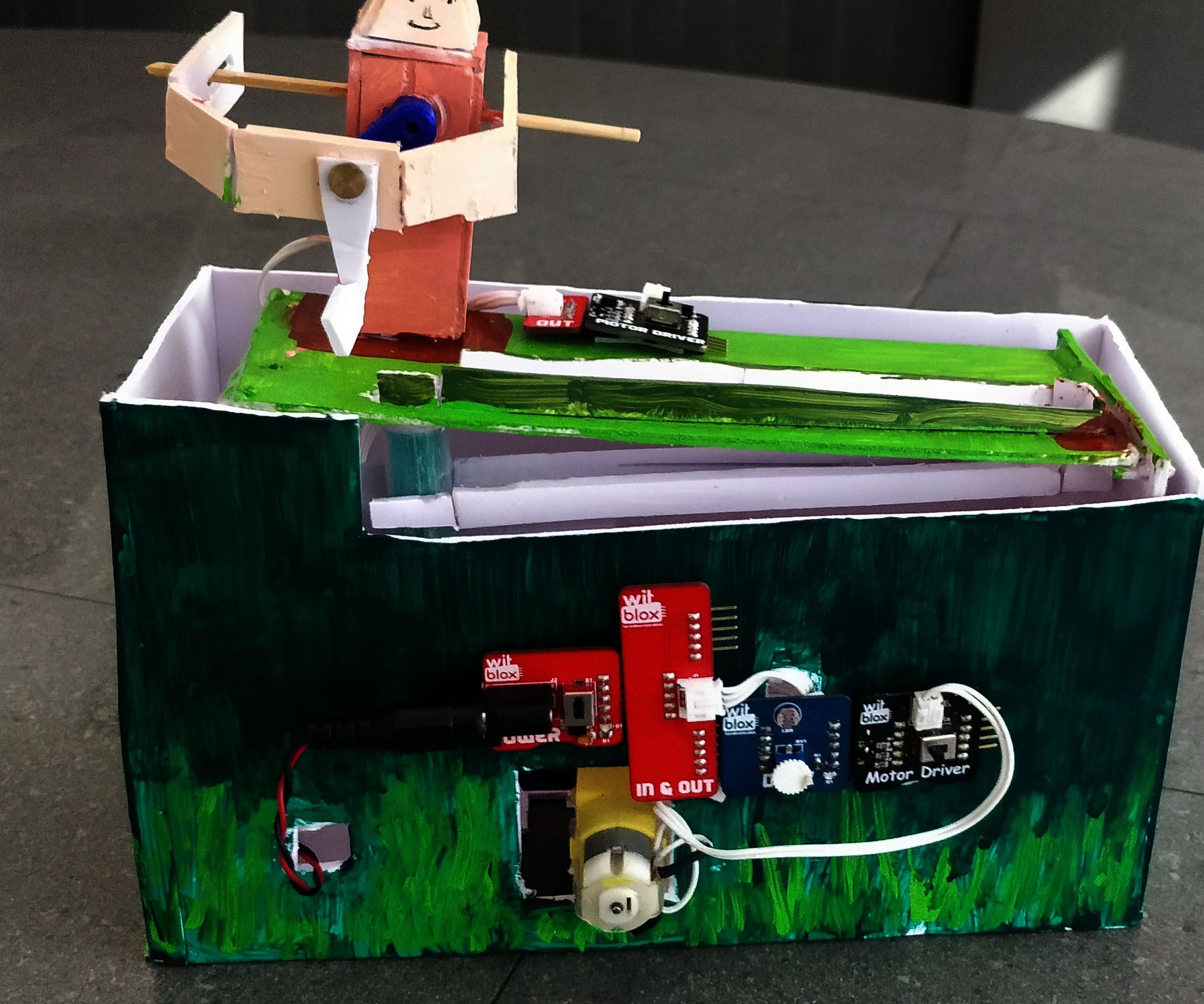

Step 2: Main Pushing Mechanism With Motor.
Main mechanism is made up of sun board by proper dimensions and a slot provided to it by which rotating motion of motor is converted to translation motion.
A red color shaft is 3D printed which is attached with motor shaft. One end of piece of straw is attached to red shaft and other end is fixed in slot of mechanism as shown in figure.
Step 3: Slowing Down of Robot Speed
For smooth application of main mechanism which pushes out the domino from robot the main phenomenon is to slow down the robot speed by adding load to the motor shaft. Rubber band is attached to motor shaft which eventually increase load on motor shaft and slowed down the speed. The attachment are shown in figures above.
Step 4: WITBLOX Kit
WITBLOX kit includes motor drivers for each of motor and a power driver wit battery. The connection of each component is very simple. Battery is connected to the power block and power block to the motor driver. Each motor driver is connected to the respective motor. You can purchase this stuff on WITBLOX or on WITBLOX app.
Step 5: Assembly
Each part is attached by using glue gun as shown in video. Two motor with wheels at one end and castor wheel at the other wheel. All other parts from part 1 to part 6 with mechanism is attached and robot is tested with excellent result as seen in video.
